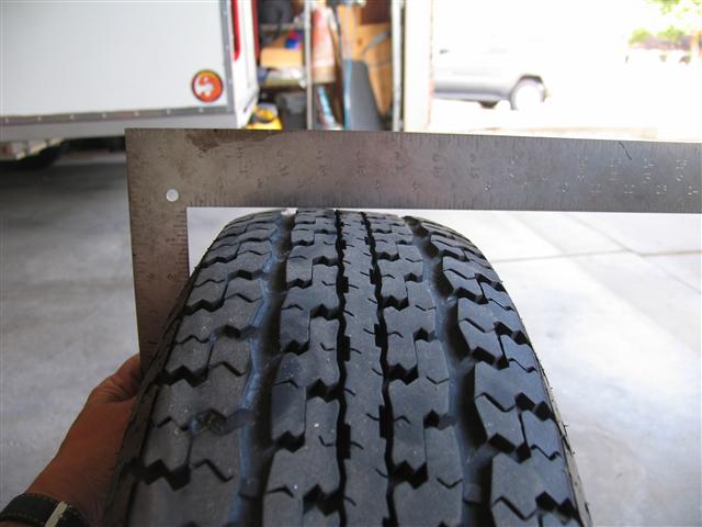

I got the Kumhos yesterday so I took the other tire off today. I got another nasty surprise as the tread had separated on that tire as well. We were very lucky to have made it home.
Its kind of hard to see in the picture but there's a big bulge around the circumference of the tire. As you can see, there isn't a lot of wear on the tires and the tread is in great shape. The guy at the tire store said they'd seen a lot of failures from the Marathons. Good thing I got two new tires!

Y'all are very lucky Bruce. There was no wear on treads on my trailer tires either but they had dry rotted from what I was told. I'm gonna remember the name of the tires you just bought next time I have to purchase some. Thanks! :thumbsup:
