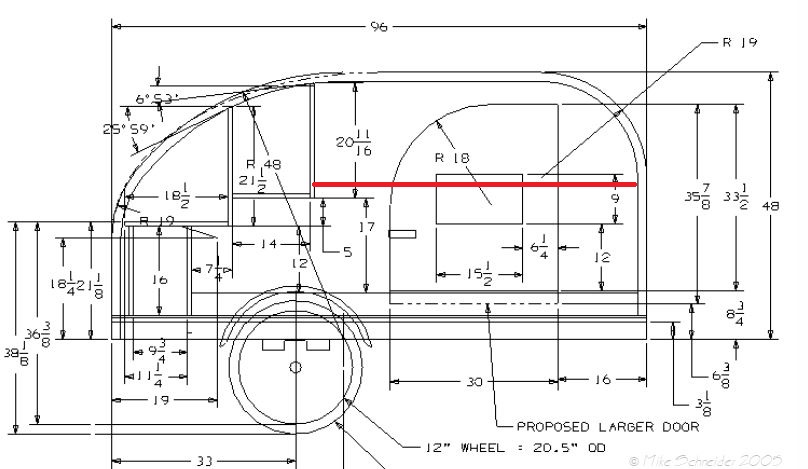

The real problem with a lengthways bunk in a teardrop is that you will be trying to fit the front or back ends of the bunk onto sloping parts of the teardrop and that makes it much more difficult to do. The one type of design that would work would be something like a Benroy that has a flat front for most of its height so that the front and back ends of the red bunk poles could attach to vertical structure:
