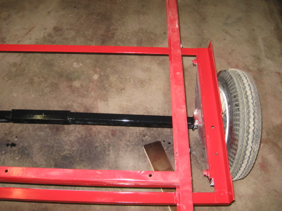

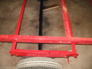

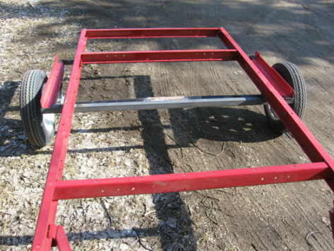

Thought I would show you how I did mine. I have the U shape axle. We use a round solid axle and welded it inside the u shape axle. I have thousand of miles on the trailer. It is about 5 years old. The only thing I have noticed is that one tire wore a bit faster than the other....
