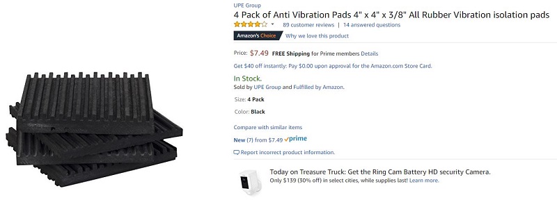

  • I am only hesitating on the remodel because I fear that compressor-style small dorm-fridge would be very sensitive to road shocks; my 2000+ lbs squareback TTT has a stiff suspension, though compliant enough to not bounce, it might be jarring to the compressor in the fridge. After 6 years, my 5k BTU air-conditioner, solidly mounted in the rear bulkhead, still works great...and it has a compressor inside, too. I was almost ready to buy one, and modify my galley in the three months I had mulled over this problem, prior to the trip, but just couldn't pull the trigger on doing it. But, after the trip, I decided to modify other things, so now's the time for the fridge/freezer mod, too.

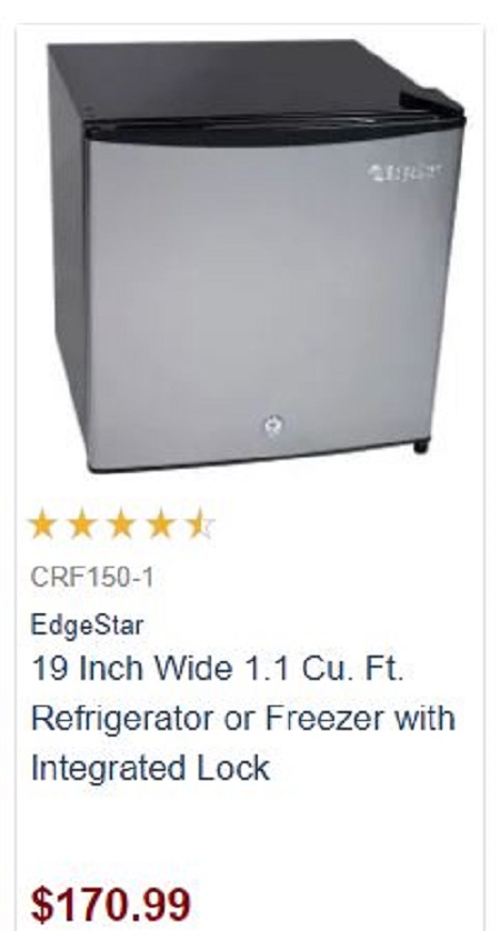

  • The only way I might justify getting the unit I decided upon using, an Edgestar CRF150-1 fridge-or-freezer (wide temperature capability), is to use it inside my dayroom/office whenever I'm not camping (I haven't camped much lately, so it would spend 99% of the time in my office).
    freezer-fridge with wide-range temp control.JPG (61.03 KiB) Viewed 1085 times
    at 20.9 x 19.8 x 18.1 inches, I'll be able to fit it in, with minor mods

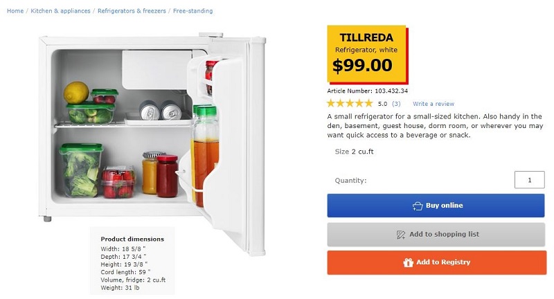

    TILLREDA mini fridge @ IKEA.JPG (79.34 KiB) Viewed 1085 times
    my alternative choice, that I know I can "sneak by" the wife
  • I fear that the small fridge's compressor might not like travelling, but then the window-unit A/C shouldn't either. So, in another month, I'll get one or the other: the Edgestar from Amazon (I've already ordered trailer-mod parts today, so my monthly limit has been reached, according to the CFO), or I'll talk the wife into a visit to the new, nearby IKEA (she can't resist a trip there!) and snag their TILLREDA mini-fridge on the way out (my usual method of shopping there with her, haha). If I have room for it, during the galley mod, I might be able to fit in anti-vibration pads, which should alleviate my fears.
    anti-vibration pads.JPG (55.42 KiB) Viewed 1085 times

    ...The only way I might justify getting the unit I decided upon using, an Edgestar CRF150-1 fridge-or-freezer (wide temperature capability), is to use it inside my dayroom/office whenever I'm not camping (I haven't camped much lately, so it would spend 99% of the time in my office).
    freezer-fridge with wide-range temp control.JPG (61.03 KiB) Viewed 960 times
    TILLREDA mini fridge %40 IKEA.JPG (79.34 KiB) Viewed 960 times
  • I fear that the small fridge's compressor might not like travelling, but then the window-unit A/C shouldn't either. So, in another month, I'll get one or the other: the Edgestar from Amazon (I've already ordered trailer-mod parts today, so my monthly limit has been reached, according to the CFO), or I'll talk the wife into a visit to the new, nearby IKEA (she can't resist a trip there!) and snag their TILLREDA mini-fridge on the way out (my usual method of shopping there with her, haha). If I have room for it, during the galley mod, I might be able to fit in anti-vibration pads, which should alleviate my fears....

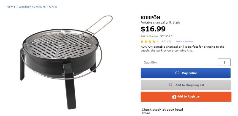

We made an unexpected trip to IKEA today, where I measured the TILLREDA mini-fridge. It will easily fit where my "cube" cooler (i.e the "Franken-cooler") now resides. However, my wife went hog-wild with her purchases (we're still furnishing the new house), so I agreed to wait a month to make my purchase (pension check time!). I did manage to grab a neat little grill on the way out, though, so I can cook with charcoal sometimes at camp, without hauling my 22" Weber kettle along (I searched for a good Hibachi, for cheap, but wasn't happy with current offerings).
KORPON grill at IKEA.JPG (62.62 KiB) Viewed 960 times
so far, everything I've bought at IKEA, for years, has been a winner... maybe this will be, also

Postby John61CT » Sun Apr 29, 2018 8:14 pm
Not so portable at 30#, but last forever long as you don't drop it on concrete
https://m.ebay.com/itm/Lodge-Logic-Pre- ... 2073574221
Let us know how that one goes, carrying Too Much Stuff
John61CT
Posts: 1958
Re: homemade 12V/115V compressor fridge?
Postby working on it » Sun Apr 29, 2018 11:54 pm
John61CT wrote:Not so portable at 30#, but last forever long as you don't drop it on concrete
I wish I could get the Lodge grill, but for as little as I would use it, solo cooking, I couldn't justify the expense. At roughly 20% of the cost of the Lodge Grill, The IKEA grill will probably do the job for me, at camp, and I'll continue to use my offset smoker grill, and the Weber. Plus, weighing about 4 lbs (1/8th of the Lodge), the Korpon grill will add little weight to my overweight and growing trailer kit(chen).
