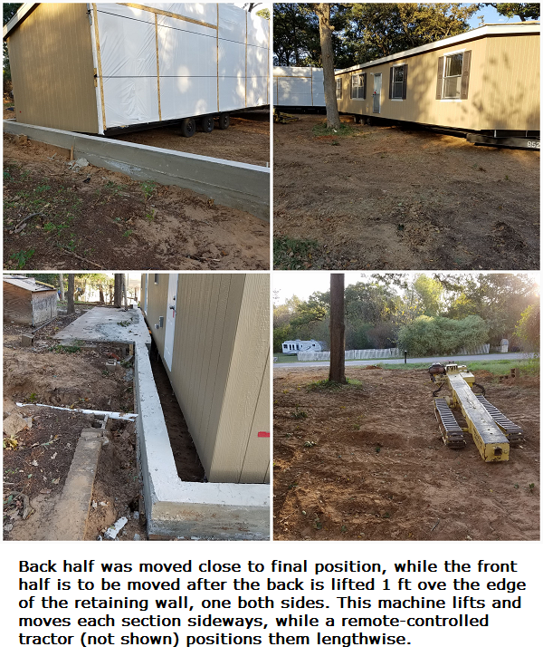

  • Quick update: the two halves of our "multisection manufactured home"
    Manufactured Homes: These are homes built entirely in the factory under a federal building code administered by the U.S. Department of Housing and Urban Development (HUD). The Federal Manufactured Home Construction and Safety Standards (commonly known as the HUD Code) went into effect June 15, 1976. Manufactured homes may be single- or multi-section and are transported to the site and installed. The federal standards regulate manufactured housing design and construction, strength and durability, transportability, fire resistance, energy efficiency and quality. The HUD Code also sets performance standards for the heating, plumbing, air conditioning, thermal and electrical systems. It is the only federally-regulated national building code. On-site additions, such as garages, decks and porches, often add to the attractiveness of manufactured homes and must be built to local, state or regional building codes.
    are now on-site, though not in place for the supports and footings, yet. Those materials, and the set-up crew, will come tomorrow. The new house is built to far better standards (I think, I hope) due to the Hud Code, referred to above, which came into effect after the 1973-4 build date of its' predecessor.
  • I was surprised at the remote-controlled tractor, and the crawler-type lift machine they used...the operator seems to be able to maneuver the halves within mm's of walls and trees, with precision. Can't wait to see him lift the trailer halves up/over the edges of the retaining wall, just over enough to set the skirting (we're using LP Smart Siding for skirting, to match the exterior) down on top, along the rear and uphill side of the house. The downhill and front sides will have the same skirting, but I'll put treated 4x4's under their bottom edge, to eliminate ground contact, after the water/electric/septic work is done.

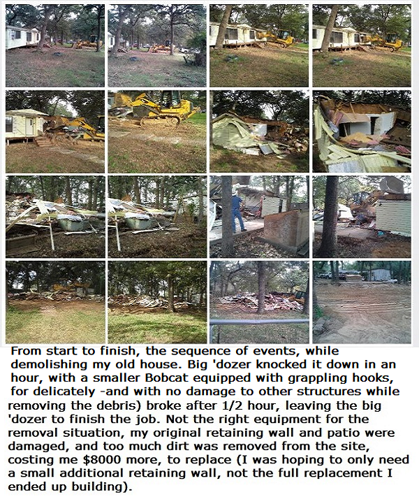

    house demo collage.png (909.14 KiB) Viewed 1349 times

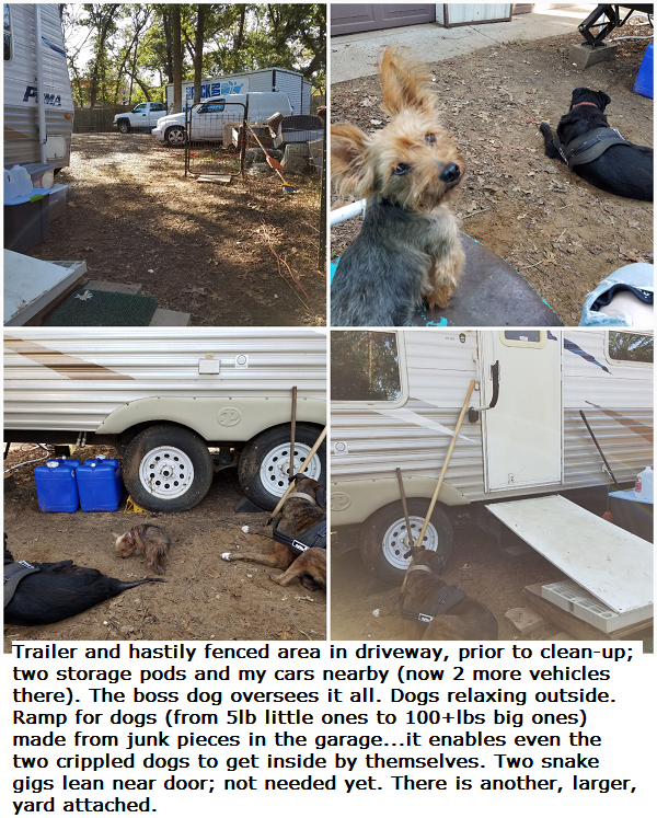

    trailer & dogpound.png (933.38 KiB) Viewed 1349 times

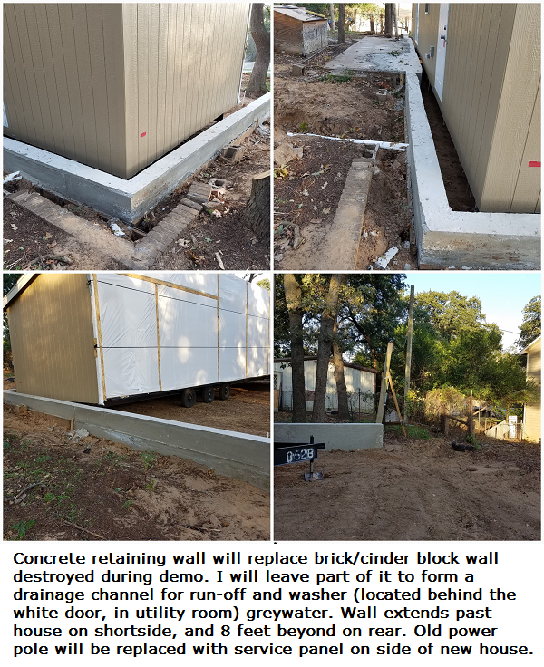

    retaining wall, greywater, drainage, power.png (918.12 KiB) Viewed 1300 times
    two halves and how to move them.png (777.17 KiB) Viewed 1300 times

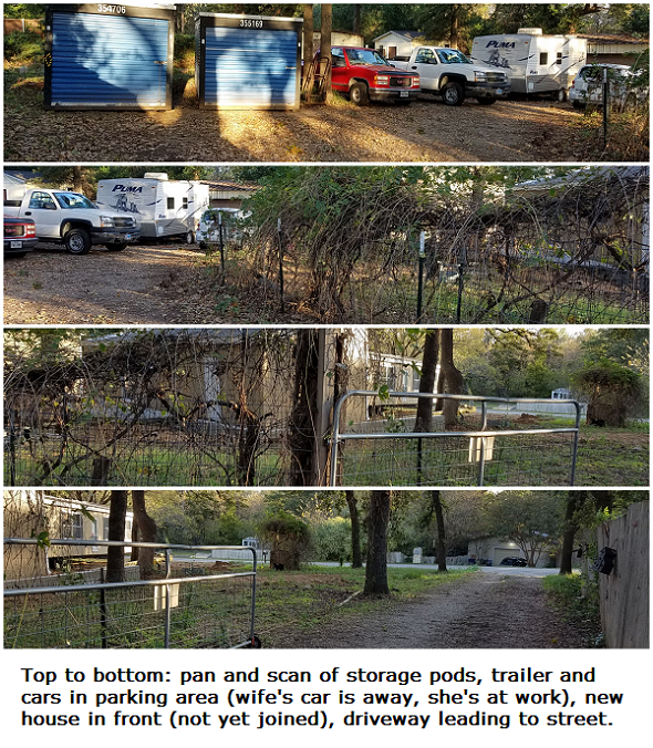

    90 degree driveway, with present arrangement shown.png (895.09 KiB) Viewed 1300 times

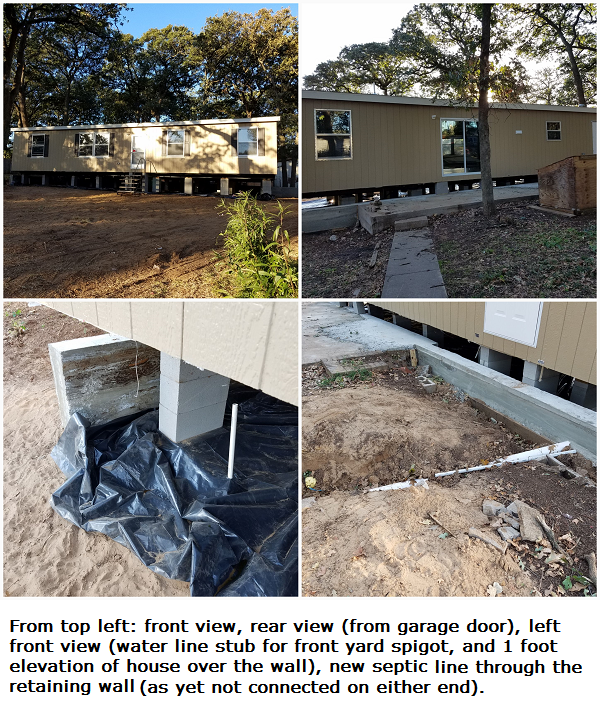

    house, with incompleted items shown.png (964.99 KiB) Viewed 1258 times

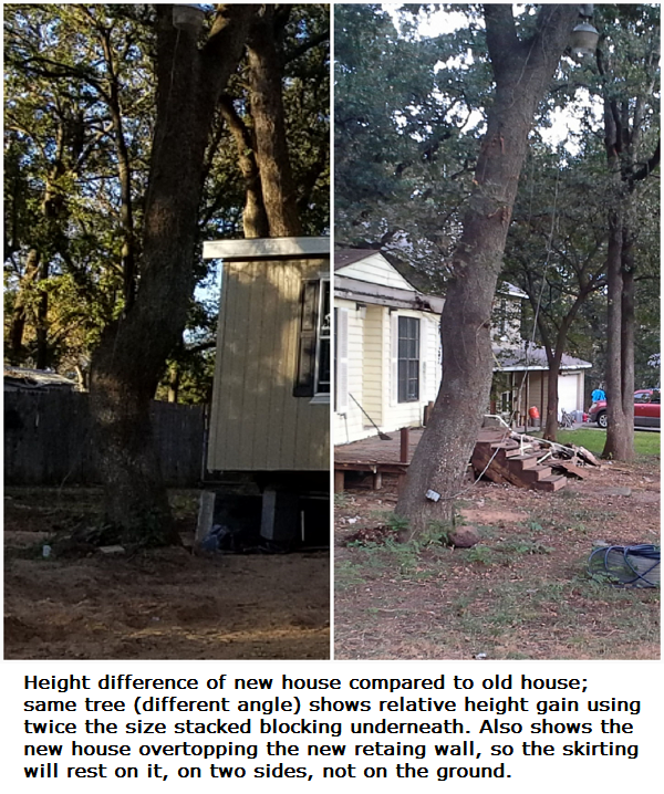

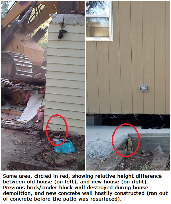

    height difference.png (964.01 KiB) Viewed 1258 times

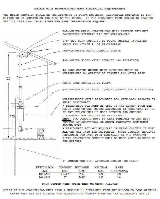

  • After weeks of trying to get electrical work started, but couldn't, due to house delivery date setbacks, then a prolonged trim-out procedure, we can have our guy make/install a meter pole (meter socket, panel, breakers, weatherhead on a tall stem)
    doublewide power pole requirements.JPG (90.32 KiB) Viewed 1194 times
    to be attached to the new house. We had our 100 amp service on a freestanding wooden pole, outside the house, but no more. It was really only a temporary service pole, meant for short-term use when the house was installed 44 years ago...its' base finally rotted thru about 4-5 months ago, and I made a tripod brace to hold it up, until I could find an electrician to change it out and up our service to 200 amps. But, the old house got replaced before that happened, so it's a good thing after all, to only have to do it once. We should get started next week on that, and the septic being hooked back up (with a better feed pipe, increasing the diameter from 2" to 3", and at a steeper angle, too...and adding a clean-out as well), and running all new waterlines from the meter...we never could find where they all ran, and the original owner had no plans drawn. All this to be done by a single contractor, so at least he won't be in his own way!

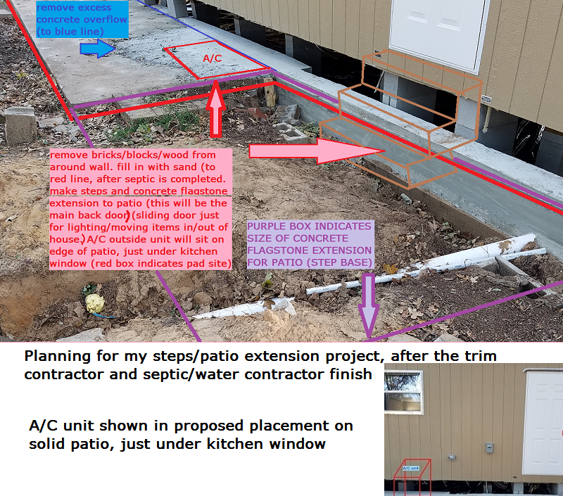

    patio extension, steps, AirConditioner pad plan.png (936.95 KiB) Viewed 1200 times

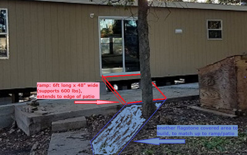

  • The wife ordered a 6 ft ramp kit, to use on the patio to load furniture into the house. I argued for a folding 4 ft model, but she prevailed. Now, I'll have to build it, then add another patio extension (of concrete pavers, or flagstones) to be able to approach the ramp at the right angle to push/haul a load up it (the patio is only 6' wide), so there won't be enough room to approach obliquely. But, there's a tree in the way, that she wouldn't let me remove earlier. Another thing to work-around.
    patio , ramp, flagstone coverage.png (616.84 KiB) Viewed 1151 times

The diagram of the electrical requirements looks different from what I've seen in the NEC code. Is it a local power utility requirement?
