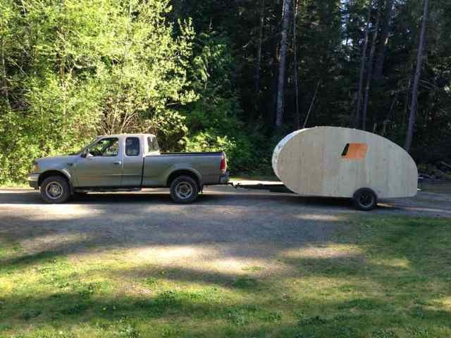

Postby Fyddler » Sat May 04, 2013 9:40 am
Thanks! Actually for as nasty as it is it doesn't hurt unless I smack it on something. The huge wrap they put on was discarded in hours is I'm an IT manager and needed finger! Probably using it more than I should but my trailer isn't going to build itself! Took off early from work yesterday and finally installed my springs, axle, and tires. It moves! I also started running my ceiling wiring. Hope to have outer skin on by end of day!
Man it looks a lot bigger in my garage!
To err is human, to really foul up requires a computer
Build Log: http://www.tnttt.com/viewtopic.php?f=50&t=55017
