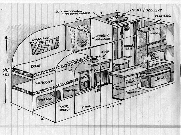

mikeschn wrote:Here's a preliminary sketch... yes, it needs some work... that's why I posted it. Lets have some fun.
KDOG wrote:I don't like the exterior galleys. I would want to maximize interior space. Just my opinion.

bdosborn wrote:
Noob wrote:Little late to the party...bdosborn wrote:
Is there anything accoss from the beds ? theres 7 ft there ...
You could turn the beds transverse, save a foot.
You vould turn just the lover bunk and take the countertop and storage under the top bunk, move the sink, where the countetop/storage was and save 2 feet ...
maybe even ad a pul out counter top just under the top bunk, so one can sit on the now turned lower bunk and have a tabble.
