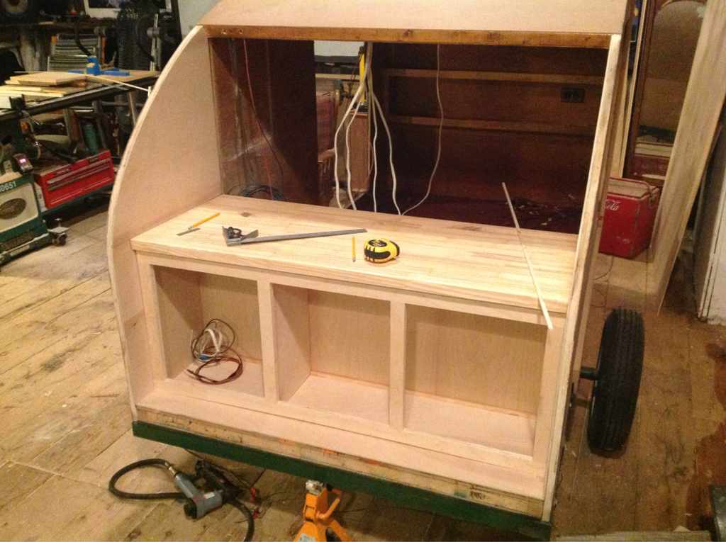

Hopefully will work in the barn on the teardrop tonight since no World Series game on .....I should be working on the galley upper cabinets tonight....this is where I am at now

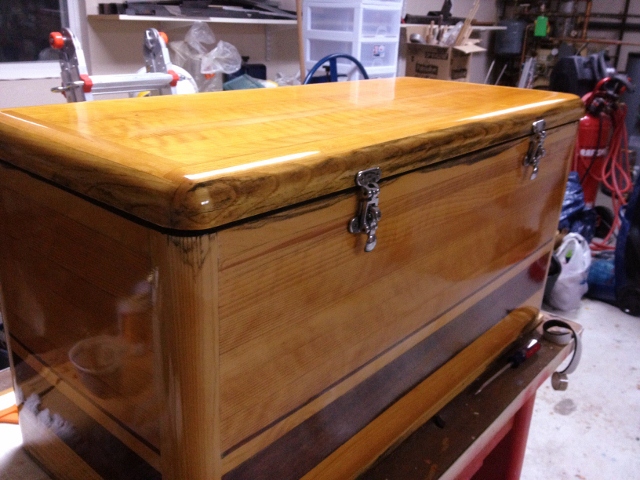

I've been repairing water damage, sanding, and varnishing for a while now...today I finished putting hardware back on the tongue box. It was in pretty rought shape as water got in under the glass along the edges and turned the ash pieces black in places. I cut off the delaminated glass, sanded back most (not all) of the black, sealed it up with new epoxy and used marine spar for the finish this time. The trailer is definately getting a patina that trailers get over time...but I think it looks well loved...

Still my favorite build of all time. Just gorgeous.

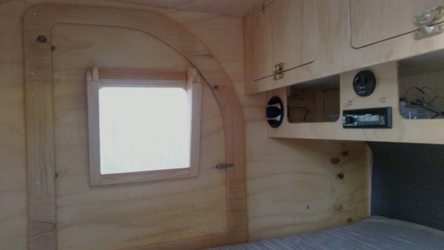

I had a really satisfying two days as my TD approaches the stage of being ready to camp. But are they ever really finished?
Electrics, fabricated a rear bumper, and did a temporary galley until experience tells me what I need. Four speaker stereo sounds great either in the cabin or from the galley.
The trailer lights are now all LED so I plan to fit a 20 watt solar panel and charge controller next week. Then there are a few small shake down trips planned :D

Juneaudave wrote:I've been repairing water damage, sanding, and varnishing for a while now...today I finished putting hardware back on the tongue box. It was in pretty rought shape as water got in under the glass along the edges and turned the ash pieces black in places. I cut off the delaminated glass, sanded back most (not all) of the black, sealed it up with new epoxy and used marine spar for the finish this time. The trailer is definately getting a patina that trailers get over time...but I think it looks well loved...
Sorry to hear about the water damage. I lost my tongue box last year and it wasn't built nearly as good as yours.
On a side note, no malice intended, sure glad I'm not the only one that has water damage.... was beginning to doubt my building skills............ :roll:
