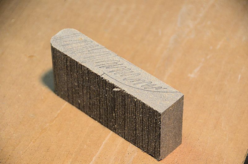

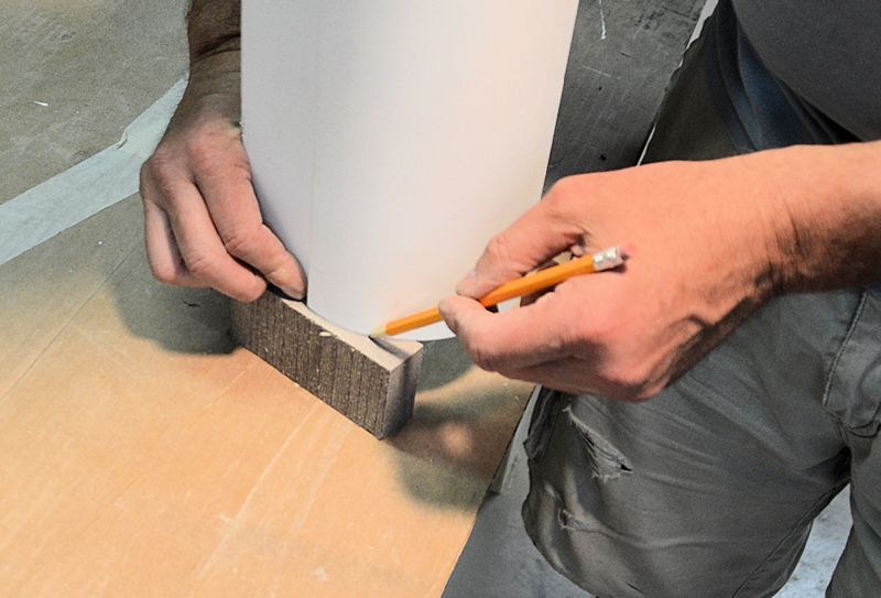

Ok, but for those who would rather DIY it, here's what I did.
Using a cutoff from trimming the TrailTop parts to fit the tub, I traced the curve on a block of "wood" that was just a little bit longer than the hinge. Wood is in quoted because I used a scrap from my deck construction - it's TimberTech composite decking board, which is mostly plastic but cuts and sands like wood.
Then I cut along the line; the portion I scribbled on is scrap. A long blade in a handheld jigsaw works fine for this; I used a bandsaw because I have one handy.
A little bit of sanding perfected fit, I also sanded off the "wood grain" texture on the flat side, and then I shot them with white primer.
