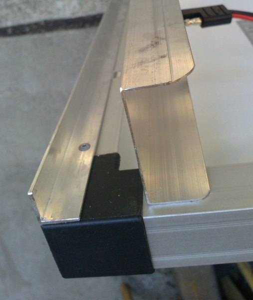

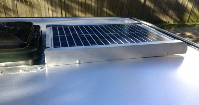

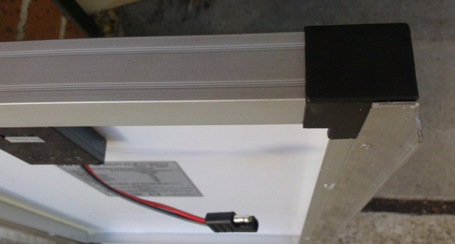

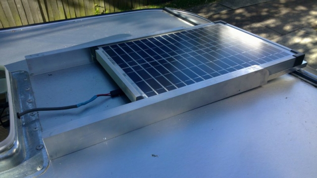

I had fun today fitting a solar panel. My TD should have low power needs. All lights are LED and I don't run an inverter or fridge. I picked up a cheap 20 watt unit and a controller so I can hard wire it into the system without cooking the battery. I wanted it mounted on the roof in the wind shadow of the hatch but easily removed if need be. It is now equipped with a plug which connects to the trailer internal wiring.
The mount consists of two aluminium channel fastened longitudinally to the roof into which the panel slides from the rear. The panel is riveted to a carriage which lifts the panel to create a cooling air space below. Once in place the carriage is secured with screws. Cost of mounting hardware? $9.50 :)

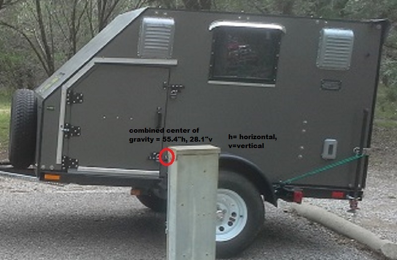

Final chapter "slide mounted aluminum tonguebox " episode: Yesterday (11/16/13), I mounted the box on the baseplate (with four 1/4-20 stainless bolts, and 3/16" steel angle stock along front and rear box walls, and two 3/8-16 bolts w/fender washers on both sides of the box/baseplate-about midway along each sidewall edge), and when fully tightened down, it would not slide. Obviously, there was binding along the slide axis, so I removed it, re-aligned the holes, re-drilled, and re-set the baseplate. While doing so, I eliminated 3 bolts per side of the slide-mount to baseplate interface (redundant hardware) and used grade five 3/8"-16 bolts and nylocks to secure. I also lubed the slide-bars! When I had the baseplate off, I also moved the support casters forward to be centered during the entire range of travel. 114349 I then added a lockable hasp at the underside handle, to secure the assembly at the fully rearward travel position (and prevent unauthorized access to the spare tire, which is still chained and locked, as well). 114350 I mounted the battery footing plate to the center (for weight balance) of the box/baseplate with four #10 woodscrews (will also mount a securing strap over the battery top, later). With the battery mounted, I drilled two holes in the backside of the box (on the right) to run the 4ga/12vdc cables thru. I used 3/4" outside diameter hose to protect the cables, and tie-wraps to lock in place. 114351 As completed so far: 114352114353 But as this next picture shows 114354, the box came without weather seal under the lid. I'll add that today, and also make a secure mount for the charger inside the box, hook up the battery (and cover the exposed terminals), and toss in all the remaining extension cords, testers, adapters, and other electrical gear I installed this box to house. All this gear transferred to the front box will bring the Tongue Weight to around 160lbs, or 11.2% of total. And, here's my new calculated "centers of gravity" (horizontal and vertical):
