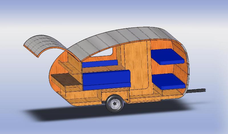

7' tall, 12' long, 6'6" wide. The porta pottie hides under the far bench and there would be two curtains that are drawn out - one against the fold out couch, the other against the dinette bed. This provides a) privacy for those beds for changing, etc. and b) allows somebody to use the can with some privacy while others may be sleeping. Guess which side your head goes on.

Postby steve wolverton » Thu Jun 14, 2007 3:59 pm
SaGR wrote:I think KJ hit the spot there :)
I agree - V nose is probably the term I wanted. :)

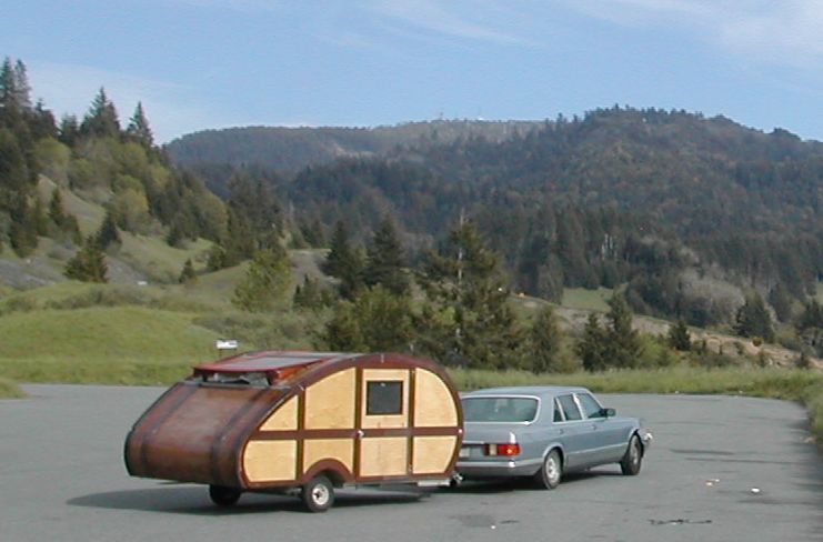

Postby Guy » Thu Jun 14, 2007 8:46 pm
Dear All,
The TD4V is 77" wide and I for one will never build that width again. It is just simply too wide for simple cruising. I would not go over six feet for the side width of the walls. The tires can stick out further. The reason for this is the extra width really makes it wider than most stock car mirrors can handle.
I really miss having a great rear view, even though I can get additional mirrors. I know many members are truckers and they are used to that, and blindspots, but many of us are not.
Below is a pick of the TD4V prototype after the Dam, and just entering the Redwood Curtain to see Dean, Joanie, and Kevin.
As you can see, my tow vehicle is as wide as you can get. Furthermore my tear is 59" tall, 77"wide x 147" Long. Total length of frame and tear is 15"6".
I have a Thetford Porta-Potty inside, which serves as the sit down shower seat. In a 36x36 bath area with a 36" closet. For Cooking Indoors, if necessary, I have access to the microwave, cooler and Coleman Hot WATER ON Demand system.
One thing I am very happy with is the height. It is not stand up for me but it certainly is what I have called a really "comfortable bend" . I can dress "standing up."

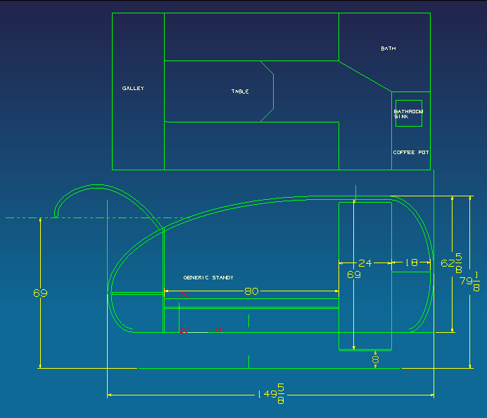

Postby mikeschn » Fri Jun 15, 2007 5:56 am
Keep the plans coming? :? Okay, here's where I'm at right now...
The galley is back in the rear (outside only)
large bathroom inside, with room at the front for a coffee pot and a bathroom sink. (In an emergency you could make a sandwich on the countertop where the coffeepot is.)
and of course the bed/dinette... the trailer is still 72" wide, and the bed is a king sized bed. The dinette can seat 4.
the shape still needs some work, an it's too tall to fit in my garage, but it should fit in the average garage. (My garage door is only 6 1/2'.)

Postby riverfront » Fri Jun 15, 2007 12:48 pm
Mike! Like the latest drawing.
Where will you install the window shaker?
How high off the floor is the bed/seat platform?
Will the drop floor only be where you walk or sit and how much of a drop below the frame or main floor?

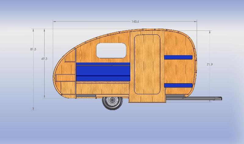

Postby karch67 » Fri Jun 15, 2007 1:09 pm
Karch,
I've always liked your design. How long is it? (The CAD file is at home.)
Thanks Mike - that design was 12' long, 81.3" high, 76" wide. 69.3" of headroom in the dropped floor and was designed on a stretched TSC chassis.

Postby steve wolverton » Fri Jun 15, 2007 3:19 pm
karch67 wrote:Image
I like this one. Is that a small bathroom opposite the entrance?
