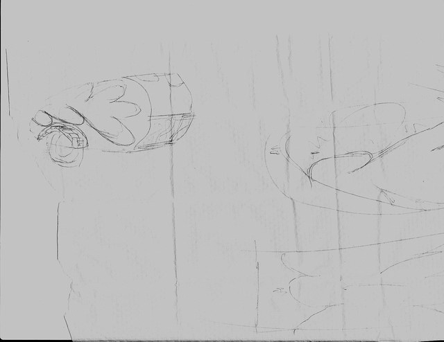

was doodling tonight at the rc raceway on an idea for the paint job and this i believe is going to be a close approximation of what i end up with..
blue and white blue darts white center double pinstripes and a truck liner guard

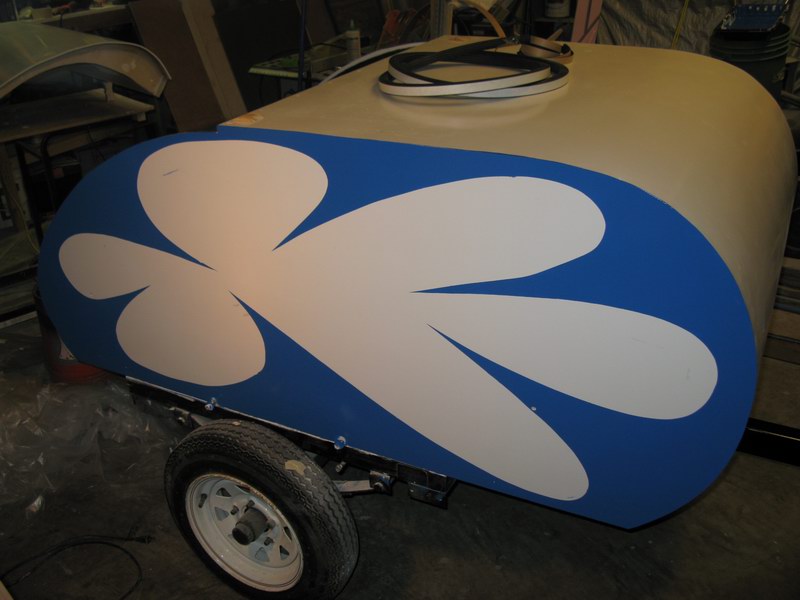

heres some pics of the recent work, the top coat of paint is getting applied and soon i will be getting molding and more paint for the 2 tone paint job.
click for larger
progress pics:
this is after one coat of paint, the top will be vinyl and the front lower will be truck bed liner (although the vinyl might change depending on cost and availability)
