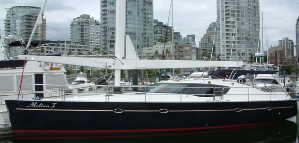

Postby Wobbly Wheels » Sat Mar 31, 2012 11:30 am
FWIW, red cedar is a good choice that has been used as coring in race boats for a long time. It's light weight, its porosity means it works great with resins and sealants, and being wood it can flex infinitely without failure.
This is one that I worked on the construction quite a while ago. It's foam core and all of the hardpoints (wherever you see anything attached to hull or deck) are Western Red Cedar, just like your siding except clear (no knots). This was a $3M boat when we built it and the NZ designer had access to design with the best materials in the world, regardless of cost.
This is the 'production' version of that boat. The redesign was commissioned by the woman who completed the first solo nonstop circumnavigation by a woman...and she built the boat she did it in !
It too has cedar - the hull is cored with cedar planking.
It's all about how you treat your wood..... ;) :shock: ;)
