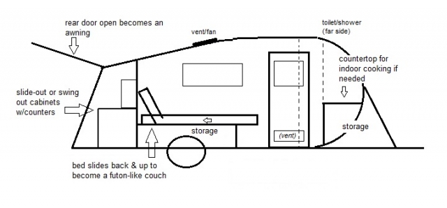

Mike -
How about something like this (excuse my poor MSPaint drawing skills):
A gently sloping roof and a more squared off rear is more aerodynamic, would provide a nice surface for mounting solar panels, and would provide more space for a galley. A lightweight flip-up rear door could double as an awning, or you could have two side opening doors maybe with cabinets attached.
I still like the idea of a slide back futon-like bed with under-bed storage. Anyway, still thinking... :thinking:

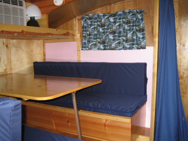

Postby mikeschn » Mon Mar 03, 2014 12:37 pm
Yes, I had planned on the bed converting into a dinette, like in the giant teardrop...
The front being a closet is a good idea. The other idea was making it a place to sit, like a blanket chest.
