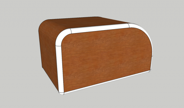

Project update: A week ago I finished the molds for the main TrailTop framing parts, and I had planned to mold the first sets of test parts this coming week. I've been traveling the past week, and unforseen circumstances will delay my return home for at least a week, so unfortunately it'll be a little bit before I can mold the parts. In the meantime, I've been working on design for a "finish free" method of assembling a TrailTop.
So far most of the concept drawings I've shown have used plywood side panels. These would get bonded or bolted to the TrailTop framing pieces, and sealed/finished appropriately.
For a "Finish Free" assembly, plywood would be used as an inner layer, with a fiberglass outer skin. Here's one way it could be done...
Home Depot sells 4x8 sheets of 1/8" "FRP" fiberglass-reinforced wall panels intended for use in wet environments like bathrooms. They also sell 4x8 sheets of 1/8" plywood. The drawing below shows how these could be used to skin a TrailTop. The fiberglass panel is bonded to the plywood using contact cement applied evenly with a roller; once they're bonded they form a 1/4"-thick fiberglass-skinned panel. The edges of these panels are sealed with a rubber u-channel molding, and the panel assembly is bolted to the TrailTop framework with 1/8" neoprene/edpm soft rubber weatherstrip.
Probably it would be best to apply the u-channel to the panel with a bead of seam-sealer inside the u-channel to form an impenetrable weather seal for the edge of the plywood. Instead of bolting/using 1/8" weatherstrip, the panels could also be bonded to the TrailTop framework, and the bonding adhesive (two-part urethane is a good choice) would also form the weather seal between the panel and the framework.
A rough concept drawing of a Finish-free TrailTop teardrop on a Harbor Freight frame. I've drawn the rubber u-channel moldings in black so it's clear where they'd be used, but I believe white is available as well.

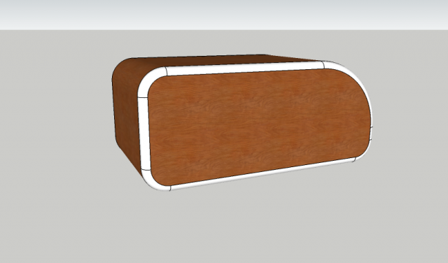

Re: "TrailTop" modular trailer building components
Postby jscherb » Mon Feb 03, 2014 12:26 pm
danlott wrote:I also think you could use the mouldings on the bottom of the trailer. They would cover the frame and the moulding flange would bolt to the bottom of the frame. Here are a couple SketchUp ideas that I had. The first one is 8 feet long and the second one is 10 feet long. Also if you do end up making other radius size corners then you could do just about any design you wanted.
Dan
Dan,
I took the liberty of adding some detail to your 10' idea...
Thanks, Dan. I hope you like what I've done to your idea :).
Postby rowerwet » Mon Feb 03, 2014 1:17 pm
I like the sketch with graphics, but unless it is a slouchy, that door is gonna be a major pain, you want the door on a teardrop to be lined up with where your butt ends up on the bed lying down in normal sleeping position. The easy way to figure this, lie down in your bed, now sit up and turn, put your feet on the floor, measure from the head of the bed to your thighs, that is the general area you want the door at, space it back a few inches to clear your shoulder without having to scooch sideways to clear.
