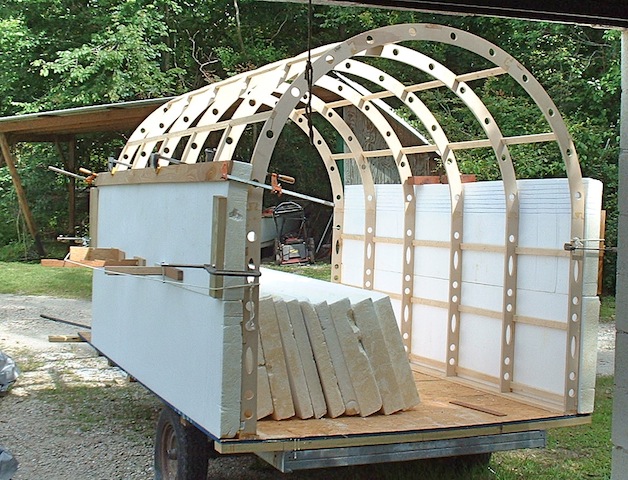

JO, Nothing says you can’t put a skeletal framework on then add foam ...  :thinking:
Here’s my skeleton ...

Wow. That's some thick foam.

Better to insulate with ... HOT down here .. :fan:

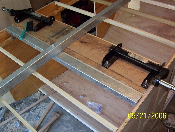

i hate to bring up old history, but here is the "frame" i made for my previous trailer.
