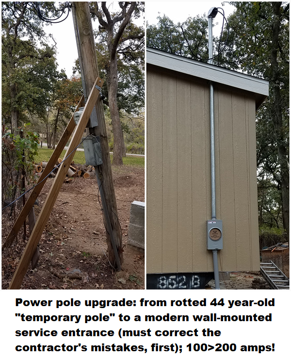

  • My real concern is three-fold:
  • 1) He put the service mast too close to a tree, so the service input line will pass within inches of the trunk. If the tree must go, that's gonna be tough, since the house is now in the way...another $1000+ for the tree guys.
  • 2) Now that I looked over the drawing again, there are other differences from the requirements...maybe it'll pass, maybe not. Items 2,6, and 7 haven't been done. Hope I can get him back before Tuesday, to fix them, or I'll have to.
  • 3) The guideline book says "all manufactured or mobile homes" must use a free-standing service pole, not a wall-mounted one. We wanted to get away from the pole, after ours rotted and started to fall earlier this year, so we asked if the normal wall mount was OK, in several phone calls to Oncor, describing in explicit terms that we had a "double-wide manufactured home". No one had a problem with that, but the guidelines show several pre-requisites must be met, that we have no paperwork to prove. So, we're at the mercy of the guys from Oncor that come out next Tuesday. On a side note: there are at least three houses (manufactured, mobile homes) much like ours, but years older, located nearby, that have wall-mounted service masts, not poles. And our contractor insists that that rule is only for RV-type mobile homes, never meant to be "rooted" in one location, nor have anything attached to the wall. I'm at the mercy of strangers here, and my time and money are flying fast from my life...I need a break soon, or I'll just give out. If it goes right, it was good luck. If it goes wrong, it's my fault. This has been as bad, or worse, than the job pressures that drove me into retirement, before I had planned.

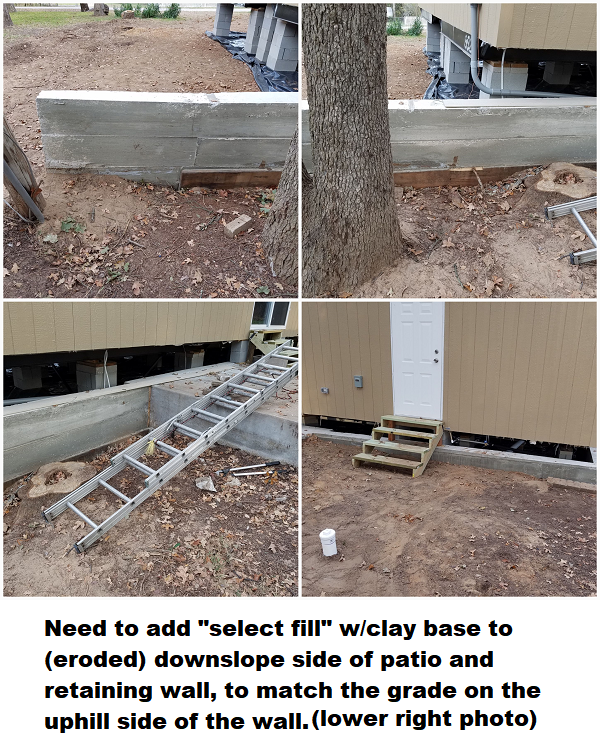

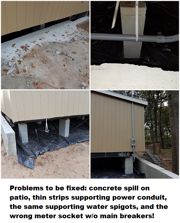

  • My contractor didn't return this morning, as he had promised, to rectify the electrical pole shortcomings, or at least to fix some other, more minor problems. He didn't even answer my calls or texts, so I left a voicemail complimenting his efforts, such as they were, because he was the only one willing to take them all on, when we really needed help, ASAP, but saying that his electrical knowledge wasn't up to code on the power situation, and that I'll go another direction on that. He was going to install gutters, but I guess that's off the schedule now...too bad, I liked the kid.
  • Once again, our electrical engineer neighbor comes to the rescue. He has already sourced the parts needed to rectify the errors of the contractor, besides those I bought yesterday, and we'll get'r done tomorrow. He's going to consult with his company's certified electrician, just to see if everything will meet the Oncor code, but he did his own install last year, without a hitch, so I think I'm in good hands, now. We only have a couple of weeks before the deadline for acceptance testing passes; we need everything tested, including the not-yet-installed HVAC outside unit, if we're going to get the factory to fix anything. The clock's ticking....

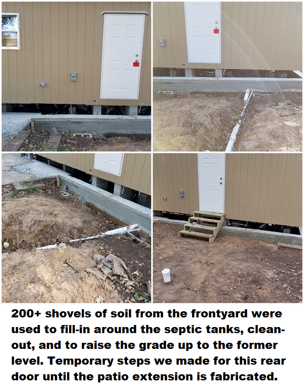

  • One of the pictures I posted yesterday showed the rear door from the utility/laundry room, with the temporary steps we made Saturday/Sunday. It also shows the septic tank filler pipe, now a larger 4" diameter (the original was 3', with a 2" pipe inside it ????), and the access/clean-out pipe that I had the contractor tee into it (I'll cover it with a protective/decorative over; perhaps a fake fire hydrant for the dogs!). It took me awhile to fill in the holes left by the various contractors, especially since I had to carry it all, one shovel at a time, from the front yard (what used to be a yard), since I thought I could do it without a wheelbarrow. Over two hundred trips (at 75 feet each way), I have the septic area covered, and it made a decent surface to place the temp steps on. Plus, we brought the entire contents of the pod in over that area, so it needed to be done quickly. But, before I level the other side, I'm converting our utility wagon into a four-wheeled barrow, just to save my knees...that was a lot of walking.
    working on the rear (utility room) door steps & area.png (803.37 KiB) Viewed 1579 times
PS...After using the small wagon all morning, moving boxes into the house from the other pod, I decided it wasn't up to the job of transporting sand/dirt/concrete materials, so I bought a 6 cubic foot wheelbarrow with a flat-free tire, already assembled, from Home Depot. I'm sure it will work out better, in the long run.
