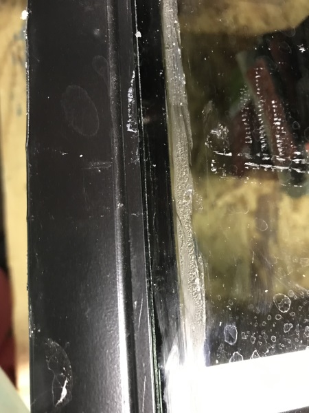

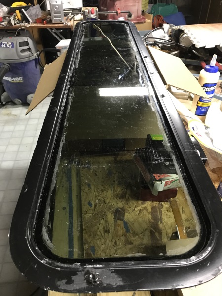

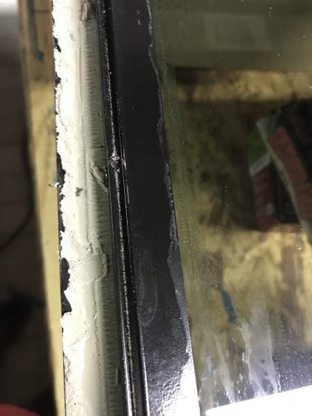

Postby mbergen » Tue Jun 11, 2019 8:12 pm
photo taken from top - side that faces out - rubber has been removed - glass sits on metal ledge below.
2019-06-11 20.13.16.jpg (114.25 KiB) Viewed 4488 times
Photo taken from bottom of window - side that faces inside of teardrop
2019-06-11 20.12.54.jpg (75.07 KiB) Viewed 4488 times
Photo taken from top - side that faces out
2019-06-11 20.12.32.jpg (86.77 KiB) Viewed 4488 times
fishboat wrote:I wish I could see one of these windows. I've searched the web and haven't found any close-ups that are useful. I have to believe the window is rebuildable-sealable with 3M 5200(black). 5200 will stick to anything and take a few days to a week+ to cure up(forever). You can put a nice surface/control the bead laid-down bead by dipping your (glove covered) finger in toluene or xylenes as 5200 won't stick to it. %200 will still cure up fine..not affected by toluene or xylenes(also sold as xylol).
I'm not sure if these pictures will help you, but I removed the window from my camper tonight, to try and work on it and took some photos.
I'm going to try an elevate the edge of where it attaches to the teardrop, so water runs around it vs on top of it, if I can figure out how, before I work on the leak. My primary problem is water puddling on the window in one corner.
As you can tell I haven't had a chance to clean them up yet.

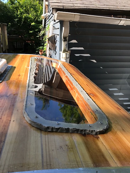

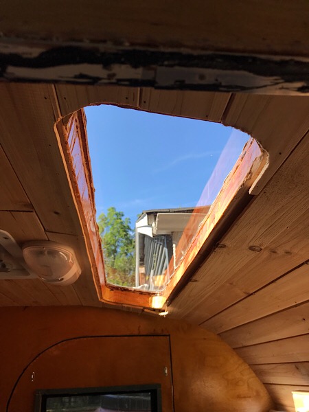

Postby mbergen » Sat Jun 29, 2019 9:41 am
This was my solution. I just finished replacing the window with 1/4” acrylic. The butyl tape is not beautiful but at least it’s not leaking. I may replace the butyl tape on the edges at some point with something I can paint blue like the rest of my trim but for now at least I’ll be able to use the camper.
