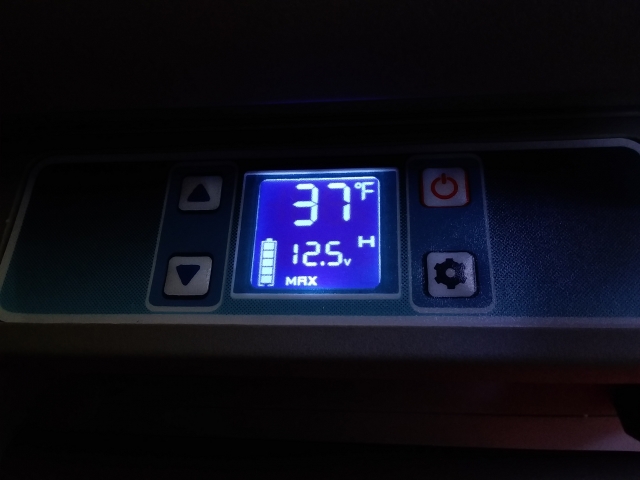

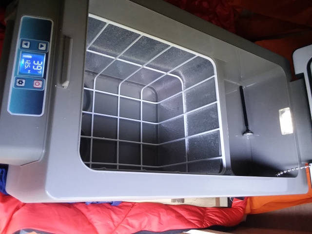

Postby TimC » Sun Aug 11, 2019 8:18 pm
Cosmo wrote:[color=#0000BF][size=150]TimC can you post a photo of the display buttons etc. for comparison?
Cosmo, below are some photos for your comparison. When I considered one of the suggestions to get a second 12v power cord for the Alpicool all that comes up is Dometic cords which in the photos look identical to what comes with the Alpicool. There could be some differences though. That big chunk of red plastic at the end is one similarity.
Related to the falling out issue I will probably do a combo of your and a couple other's ideas for solving the plug falling out issue. I finished my trip with a small piece of rolled up electrical tape to wedge the plug in the socket. That worked all the way from Mpls to home, some three hundred miles of bumpity bump. In addition I've been in cloud cover for the majority of the weekend and despite that my 100w panel and 144ah bank have maintained 12.5v with the fridge cycling constantly from about 35 to 32 degrees. So far I'm happy with the fridge.
I'm going to combine several of the suggestions for improving the power cord. I like the idea of having a way to plug it into a standard 12v socket down the road (with rolled up tape wedge) in case I use it for other than the TD. I use a 50a Anderson Powerpole plug to attach my solar to the TD and that experience has been much better than using the MC4s I used to have to struggle to disconnect (even with the tool). So, I ordered 15a Anderson Powerpole plugs and I will wire one set direct to the battery (bypassing the main kill switch). I'll cut a short pigtail with the factory 12v plug from the fridge and install APP plugs for occasional use elsewhere. On the fresh cut end of the fridge cord I will install a set of APP plugs to use mostly with the hardwired one on the TD and occasionally with the factory pigtail. Other than finding a way to mount the APPs so they aren't flopping around somewhere I think I have a good plan now. Thanks all for your input.
Tim
Alpicool factory plug
Alpicool CF35 control panel There's nothing in the fridge. I just jacked it up to 45 degrees on "standby" while the batteries recharge tomorrow. I still wonder about that battery meter on this fridge. This is after returning on my trip and the batteries hadn't been charged back up all day. 12.5v on the fridge meter should translate to four bars on the bar chart graph (80%). Maybe it's just on the verge of flipping off one light?
Another interior shot
Tim
