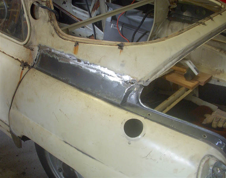

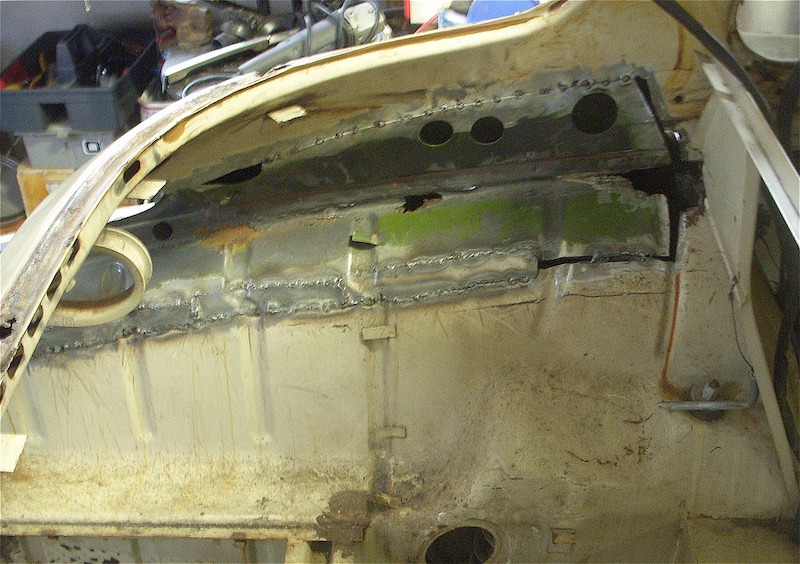

Postby GPW » Sat Nov 02, 2019 5:01 am
Welding along , the machine working fine ( especially for someone with so little welding experience )… :thumbsup:

Postby OP827 » Sat Nov 02, 2019 8:08 am
That is good to know :thumbsup:. Did you use .30 or .35 flux core wire?
OP827
Posts: 1596
Images: 414
Re: HF welding machine ???
Postby RJ Howell » Sat Nov 02, 2019 3:40 pm
Those welds look pretty good to me. :thumbsup:
You should see some of mine.. :shock:
I can solder or braze, yet welding is just past me.. :cry: I need to practice it more!
With what you're doing, and this thread, I brought out my torch again to practice up on brazing and torch welding. It just kills me that I can do this and not get the hang of a stick or Mig welder...
So from me: :thumbsup: :thumbsup:
