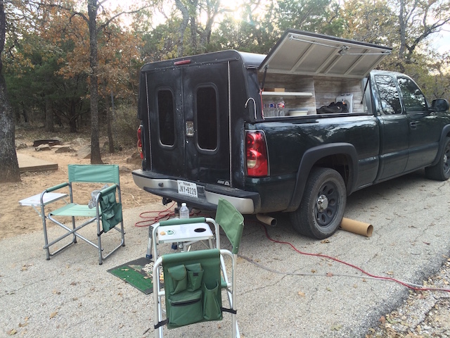

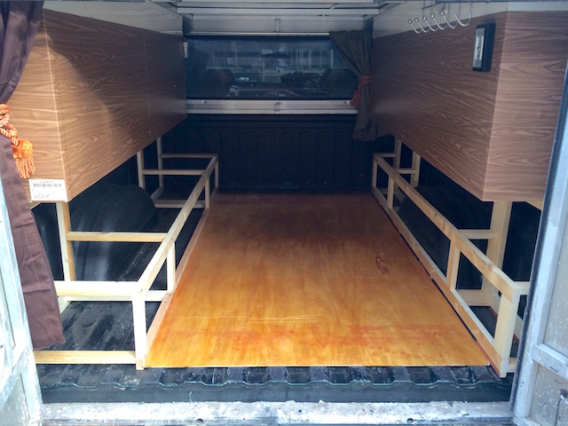

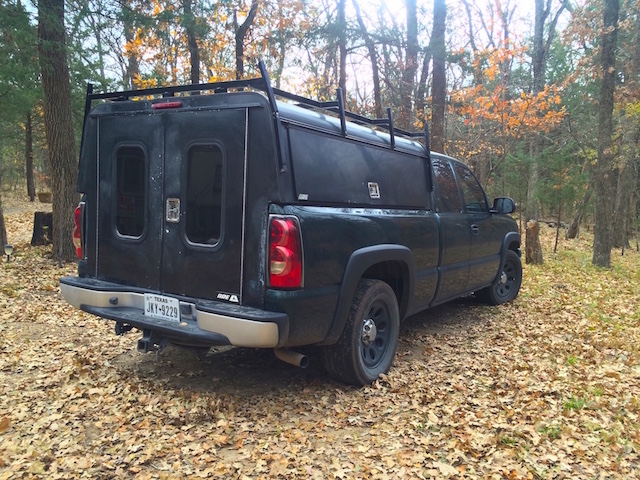

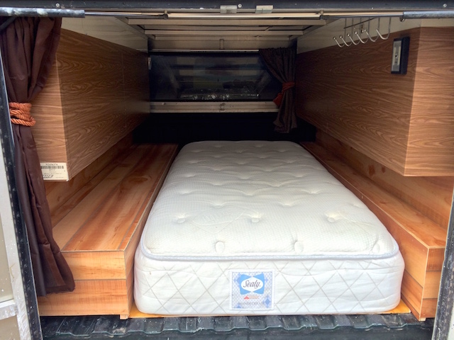

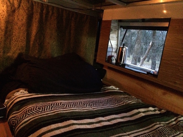

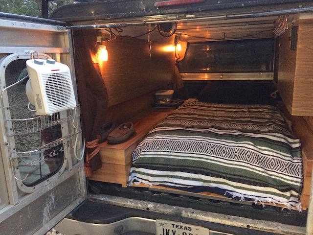

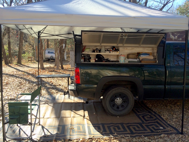

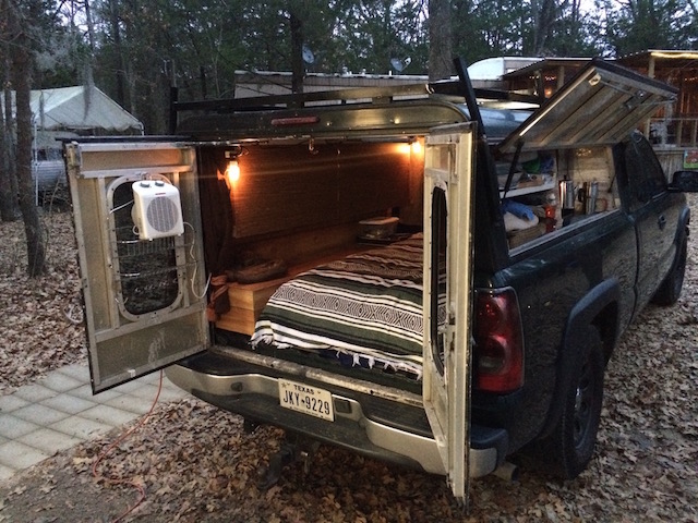

I bought an A.R.E. Commercial truck topper off Craigslist for $300. It has nice vertical double doors and side storage. I cut a hole in one side to allow a passthrough so I can wake up, plug in the percolator and push the side door open to enjoy the sunrise while still under the sheets. I put a single innerspring mattress in the bed slid to one side and built shelving at the bed height to cover the wheel wells and they just sat in there so it could easily be turned back into a truck bed by simply siding out the mattress and the two side shelves. It worked great for months and I camped in it three times until I finished my canned ham rebuild, it worked great.
Thomas

Postby 2bits » Wed Oct 27, 2021 7:59 pm
More Pics
Thomas

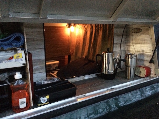

Postby 2bits » Wed Oct 27, 2021 8:00 pm
Last pics

Postby 2bits » Thu Oct 28, 2021 6:47 am
cluttonfred wrote:
2bits wrote:I bought an A.R.E. Commercial truck topper off Craigslist for $300...
Thanks for sharing, 2bits, some neat ideas in there even if you had a lot more space in your truck than in something like the Maverick. How would you compare your truck cap camper experience with towing your canned ham? I am still debating whether or not a small truck camper is the right solution compared with towing a teardrop and outfitting the truck bed with a basic cap to serve as galley and storage. Both have pros and cons. Cheers, Matthew
for a truck camper for your size truck, I would probably need to increase the height. check out Capri cowboy campers. you can find them used and they still make them new exactly like they did in the old days so it has that vintage feel to it. With a truck camper, removability is key, at least for me I couldn't live without my truck bed.
It is a different experience completely from teardrop or truck bed to a tiny trailer. A truck bed camper or teardrop is the same as the name of my first teardrop a "Luxury Tent" since the whole camper is the bed and everything else is done outdoors. My '68 Scotty was literally the same size as my teardrop except 1 foot wider and for that same footprint I got so many more amenities indoors. Some people smugly say "I camp outdoors" like you are somehow cheating if you want to put your pants on while standing up. Teardropping IS great, it is just a different experience, sort of like driving an ATV or a side by side, they are both cool. I wanted options... I love sitting outside having my coffee in the morning BUT I also love sitting INSIDE having my coffee when it is 30 degrees outside and raining. After 8 years going to the bathhouse I moved into campers with a bathroom and shower for that same reason. While many people just move into a huge new camper after a while, when I got my brand new camper 6 mo ago, I never lost the same tiny trailer mentality that I first began with, so I have literally the smallest production trailer made that has a full dry bath, 14 feet long and 2500 lbs, I am still stopping traffic with people laughing at me at how small it is so I feel like I am still in the club :lol: I have my camper van also for when I want to pull my side by side to go off roading. That is also a huge benefit to a truck camper, you can pull an ATV or a boat. A truck camper also has no title, registration, no tires to go flat or wheel bearings to maintain. I guess it all depends on the level of amenities to the experience you prefer. for me I had to try on a LOT of shoes to find the pair I truly liked.
In 2008 I started in literally the exact same place as you... wanting to build a truck camper, my buddy turned me on to this site and I was hooked on the coolnees of teardrops. Since then I have been through 12 campers finding what was just right, 2 teardrops, 3 truck campers, 2 17 foot vintage campers, 2 10 foot vintage campers and 2 vans and now my new production model 14 foot camper which of course I customized since by nature, us camper builders just want it our way haha.
I think I am finally done :? 8) :beer:

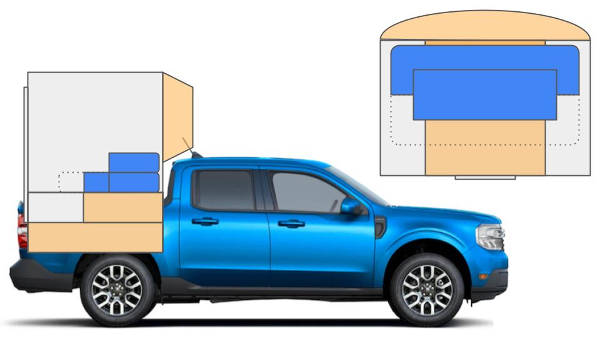

Postby alyoko03 » Thu Nov 11, 2021 8:44 am

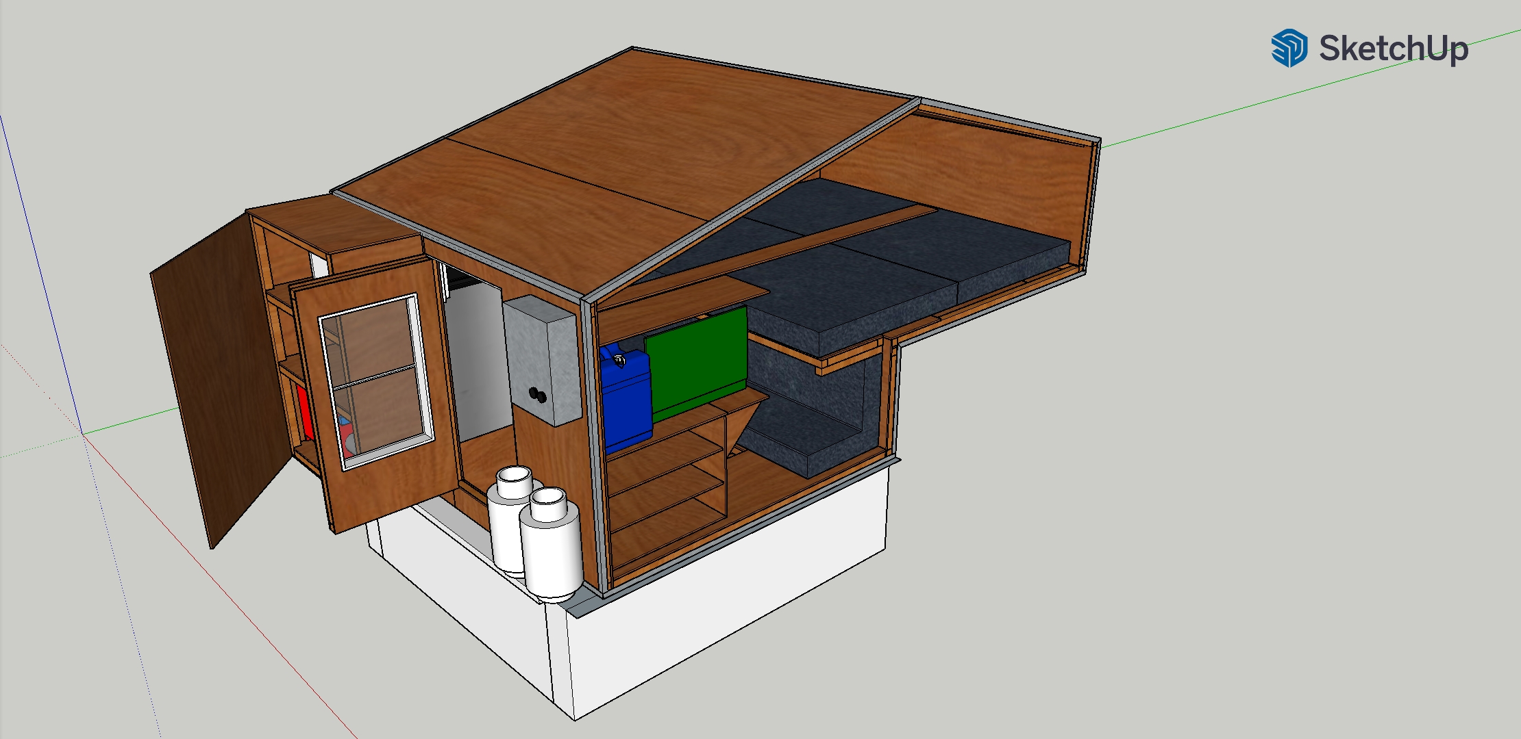

My sketchup of a truck camper. Fits 5.8, king size top bed, twin bottom. Fridge, microwave, diesel heater, propane hot water, porta-potty, 2-11 pound propane tanks. Peak roof is about 7ft, enough room to sit up comfortably on the top bed. About 20gal water in 4 jugs. 2300w gas Gen on cargo carrier. 2 peace door allows you to close tailgate.
5.8 truck camper

Postby cluttonfred » Thu Nov 11, 2021 9:07 am
alyoko03 wrote:My sketchup of a truck camper. Fits 5.8, king size top bed, twin bottom. Fridge, microwave, diesel heater, propane hot water, porta-potty, 2-11 pound propane tanks. Peak roof is about 7ft, enough room to sit up comfortably on the top bed. About 20gal water in 4 jugs. 2300w gas Gen on cargo carrier. 2 peace door allows you to close tailgate.
Neat design, I like the rear external locker extending your storage, could do that on both sides of the door even in a camper that fits with the tailgate up. The angular roof looks straightforward to build as well.

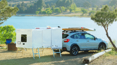

Random thought...for trucks with very small beds, what about a horizontally-telescoping camper to add extra length only when you need to bed down for the night? Basically you'd have a little couch or dinette, a tiny galley, and maybe a slide-out portable toilet in the main part of the camper in the pickup bed. When you want to sleep, the rear wall complete with door would slide out to form an extension with hammocks or fold-down bunks or just mattresses on the floor. It could be a couple of rigid sections, like the Hitch Hotel pictured (but T-shaped to fit the truck bed, of course), or it could be tunnel-like tent, or a combination of the two. Anyone ever seen anything like that? Any particular pros or cons that come to mind? Cheers, Matthew

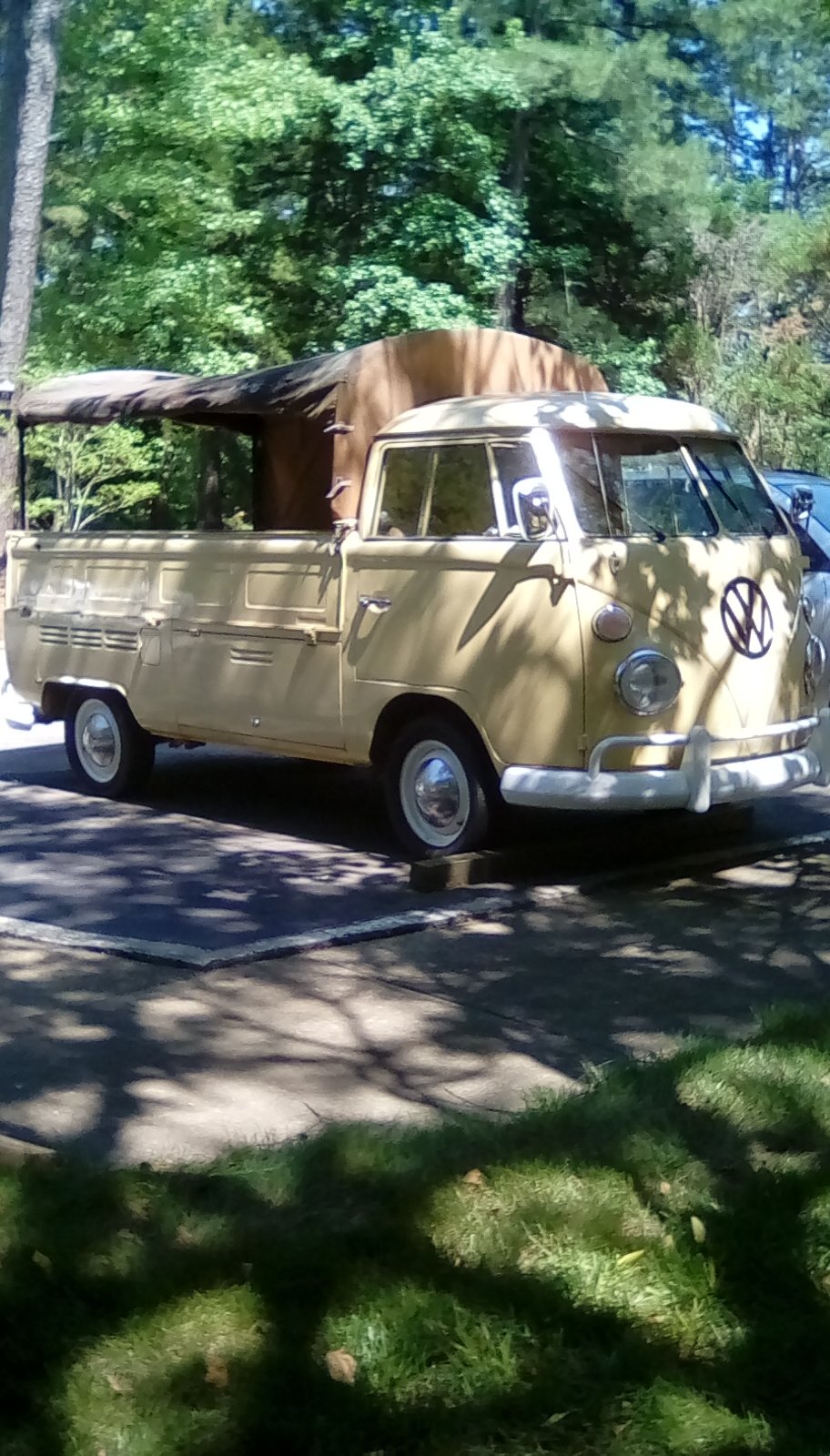

Postby rebapuck » Mon Nov 15, 2021 3:25 pm
I've gone "tent" camping in the back of my VW truck.
