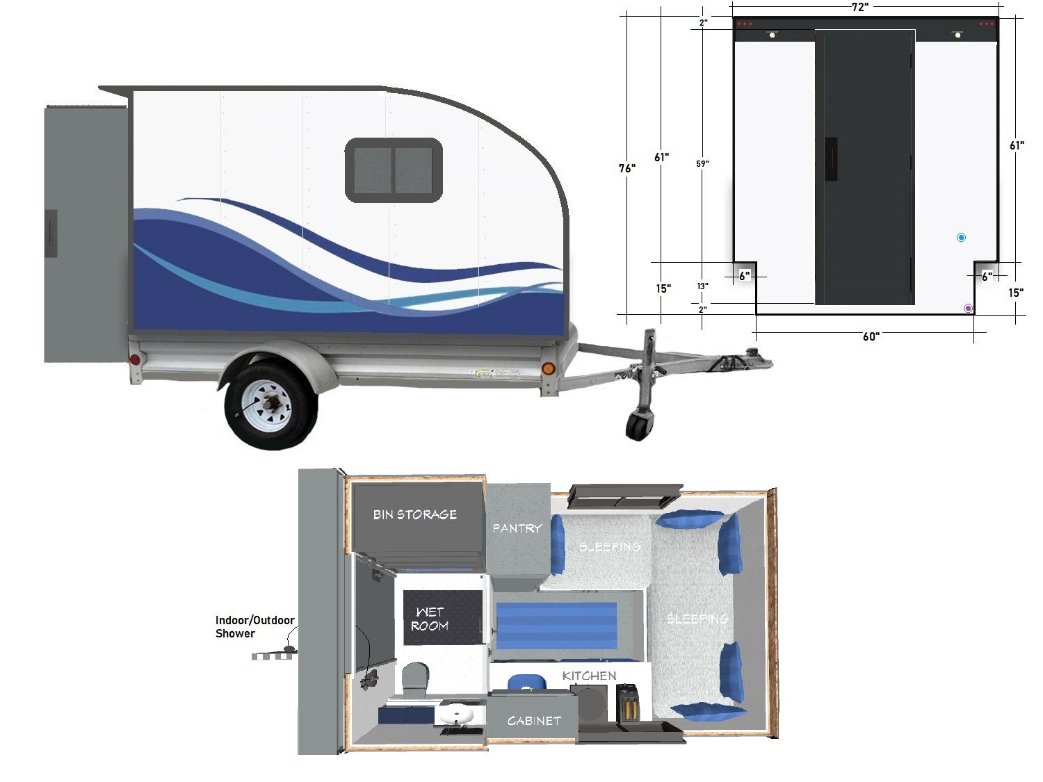

Postby Buddy-and-Missus » Sat Nov 25, 2023 4:15 am
We hit most of the list with my design.
I'm a small footprint home designer but I have to say this was a challenge.
Ours should (hopefully) weigh in at about 1000lbs when complete.
I didn't like the idea of bringing the outdoors right in to the trailer when dirty after a day outdoors so I designed ours with a mudroom/bath combo, the shower is indoor/outdoor and the wet room/mudroom area where you enter is large enough for a collapsible tub.
Height is plenty tall for my 6' hubby and has a load of storage.
Our design slides into a utility trailer.
[img]
[/img]
White Blue Design Final.jpg (225.79 KiB) Viewed 5796 times
Buddy-and-Missus
Posts: 124
Joined: Sat Aug 12, 2023 6:45 am

Re: It's time for a new Generic Standy Design...
Postby KCStudly » Tue Dec 05, 2023 9:59 am
The sleeping area along the streetside wall looks extremely short. Does that bunk get made up bigger parallel to the forward crosswise bunk using a folding platform? Otherwise I can't imagine two people laying comfortably at 90 deg with their feet in the same spot. :thinking:
