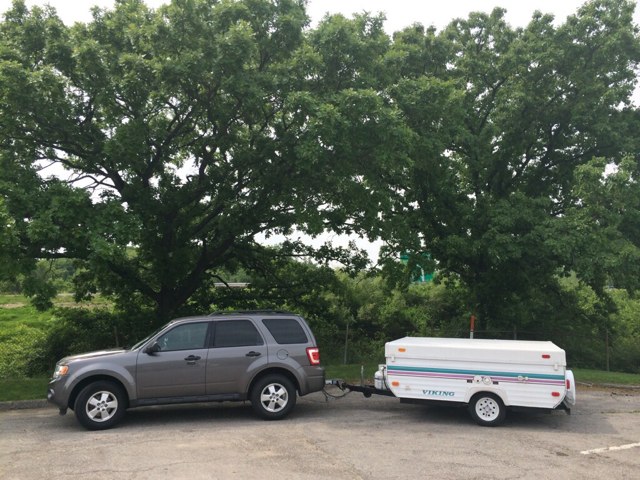

Postby unclemark » Wed Sep 17, 2014 7:45 am
1995 Viking SP175. 103 inch box length. Thanks!

Postby jscherb » Wed Sep 17, 2014 9:54 am
How about something like this? Your photo was of the side without the door so that's what I drew on; the other side would have a door, and you could do a traditional teardrop-style galley in the back.
