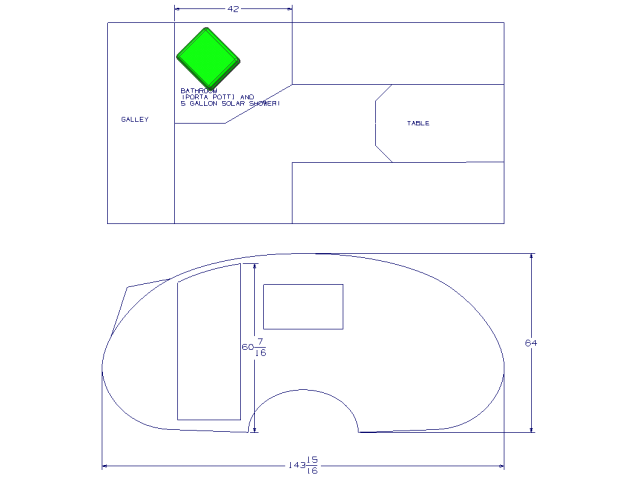

Karch's trailer design is very nice. It's a pretty tough act to follow, I'll agree. What makes that trailer work is the width... it must be like 78" or so...
If you shrink it to 72" so you can see around it while you are towing, then the bed has go be rotated 90 degrees.
But you definitely get a lot in a small package, no matter which width you build.

Postby mikeschn » Fri Jun 15, 2007 8:06 pm
Ken,
That would make a nice teardrop standy!!!

mikeschn wrote:Keep the plans coming? :? Okay, here's where I'm at right now...
I like it, but the rear hatch at 69" would be just right for samacking the upper edge of my forehead.
My current TD has a latch on the hatch (sam I am) that is at that same level, and I bump it regularly. Very annoying.
Unless you want to warn your 70" tall frineds to duck all the time, you may want to take a little off of that hatch or make it open further.
CD

Postby mikeschn » Sat Jun 16, 2007 4:48 am
Here's an idea for a door behind the wheel standy, using a stretched raven argonette profile...
This gives us an option...
We can combine the bathroom and the galley, making the trailer shorter.
We can access the galley from inside...
