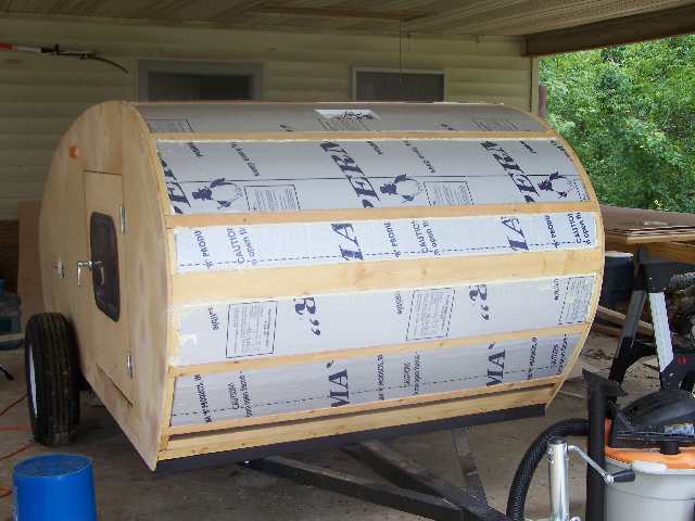

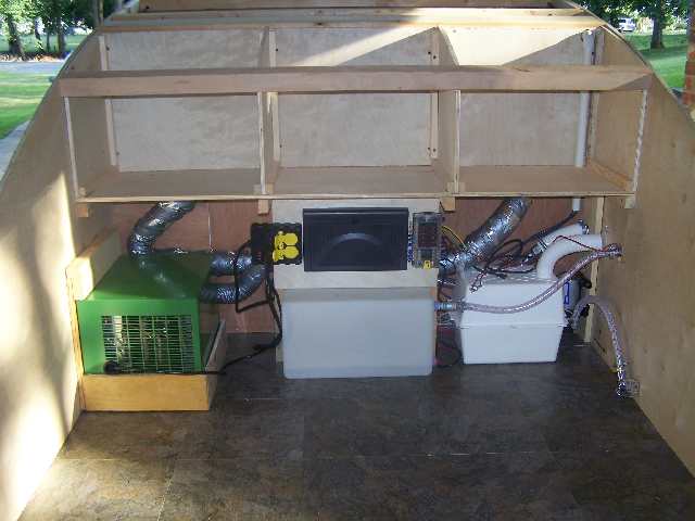

Well I got all the components in the bulkhead installed and working. water tank plumbing finished and the outlets for 110, 12 volt and coax ran into the cabin. So tomorrow will be all about insulating the top for closing it in.

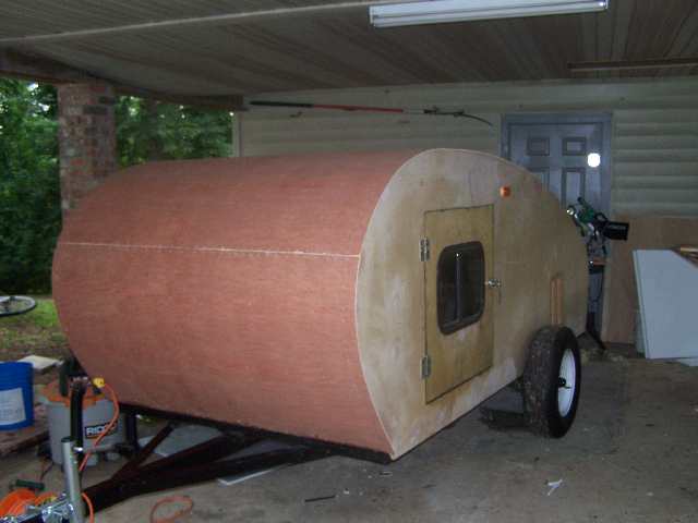

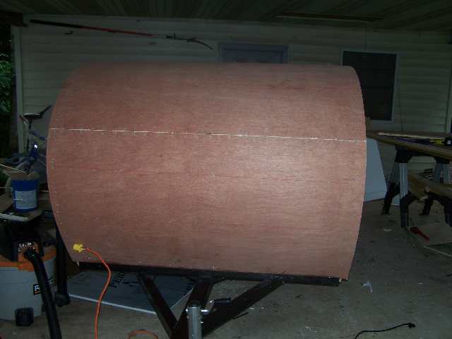

bdosborn wrote:Wow, that looks great. Any trouble bending around the front curve? What kind of wood did you use?

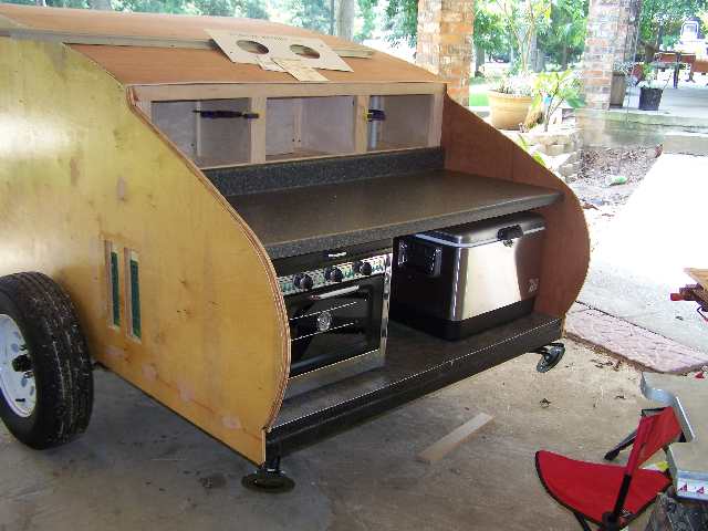

dmckruit wrote:I really like your build. What are the dimensions of your trailer frame? You seem to have a lot of room for stuff behind your galley counters. Is it 8 ft?
I really like your idea with the PetCool. I think I will use your idea in my construction.

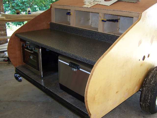

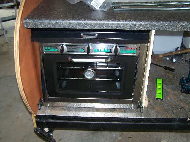

Eddielbs wrote:dmckruit wrote:I really like your build. What are the dimensions of your trailer frame? You seem to have a lot of room for stuff behind your galley counters.
The TD is 11 foot 6 inches long by 5 foot 1 inch wide. I also cut down my bed area to only 78 inches. to gain a little more room in the bulkhead for all the stuff. I got the idea about the Petcool from SteveT's FishINN. It is well worth the money to have a quiet unit built in to the TD. When the pet cool is running its about as loud as my central unit in my house.

planovet wrote:Ahhhh, now it makes sense. I was wondering how you had all that room in the galley. I was also wondering what I did wrong to not have as much. But mine is only 10' long and yours is a foot and a half longer. That 18" makes a BIG difference. Nice job!!
dmckruit wrote:What did you do about the controls for your PetCool? Did you just cut an access hole in the back of the cabin to get to the controls, or did you rewire to a thermostat?
