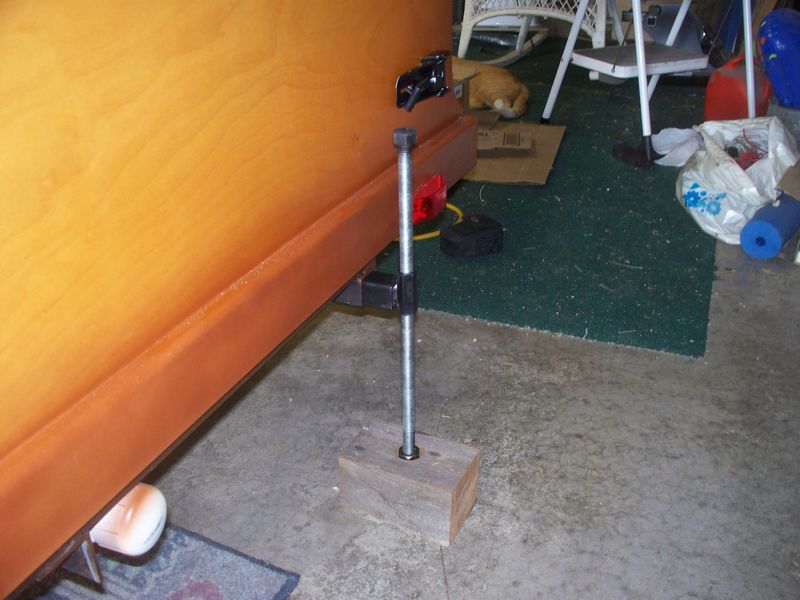

Postby oakinteriors1 » Mon Oct 06, 2014 9:07 am
My homemade levelers...
