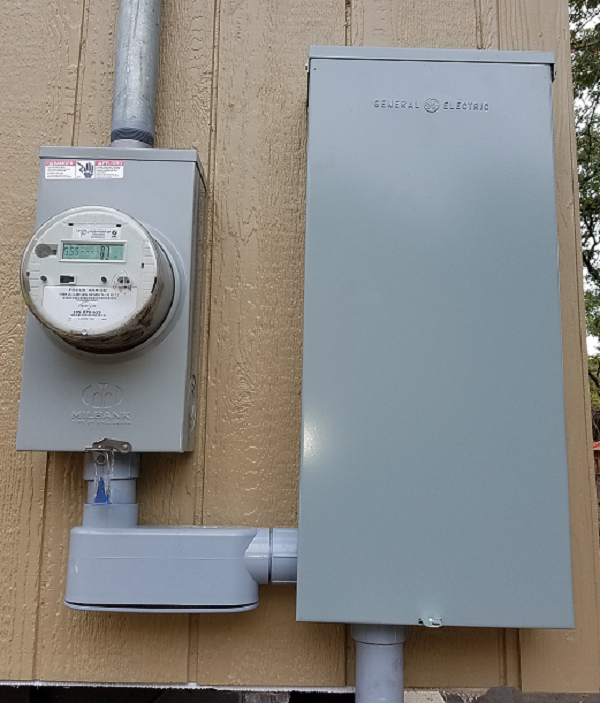

  • I typed the preceding post about 7 hours ago, and tried all early afternoon to submit it, but my router and the forum were not cooperating. So, I submitted it now, when I returned to the TT, following several trips to the house, moving stuff, packing the fridge, then looking underneath the trailer to route the dryer exhaust vent.
  • It took me awhile today to be able to bend over without stumbling, since my vertigo returned this morning after two days respite. When I did, to peer under the trailer, with my wife, we discovered that the whole drainage pipe had parted, and was no longer connected to the septic tank infeed pipe. My wife stayed in the house last night, doing the usual things, using the sink, bathtub, and you know, while I remained with the dogs in the trailer. So, as you might expect, there's a lot of water under the house, and maybe more. Totally flabbergasted, we both texted our ex-super-contractor about fixing what he obviously left incomplete, when he fired himself over our disagreement concerning the electrical hook-up. Little did I know that the drainage was also incomplete, since I didn't crawl under to inspect, as I should've, though my wife did, when she wrapped the exposed waterlines. I blame myself for not inspecting his work, which was not good on many points, but he said it was done, and I basically trusted his word. My error.
  • I never fired the kid, but he never returned after our disagreement on what was needed to get the electrical up to code. I ended up correct, as the Oncor sub-contractors agreed, and my neighbor who did the fix-up work, also agreed. We have electricity now, and probably wouldn't, if I hadn't insisted on specific items that the contractor omitted.
  • He responded awhile after we sent separate texts to him, with photos, and he texted back that he would make it right, ASAP. We'll see, but I'm going to inspect his work first-hand, if I don't fall over, and my wife says she will be under the house, as he works. Maybe, maybe not. But, if he actually fixes it, then all is OK, and he'll be "somewhat" forgiven by my wife, but I'm gonna need an apology and explanation of why he didn't fulfill his promises before, after we seemed to have semi-bonded, while working together. Just when I thought I had found an honest (but maybe not totally competent contractor)....
    completed electrical install (for now).png (596.47 KiB) Viewed 1765 times
    tagged meter proves that my insistence on the electrical install needs, was indeed correct

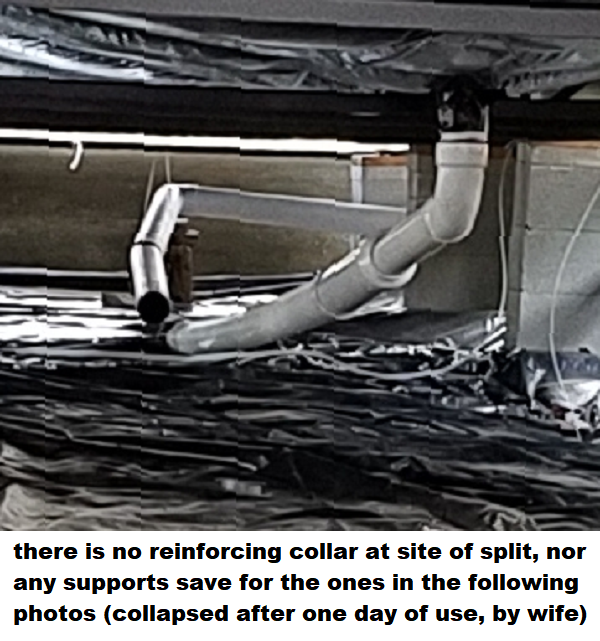

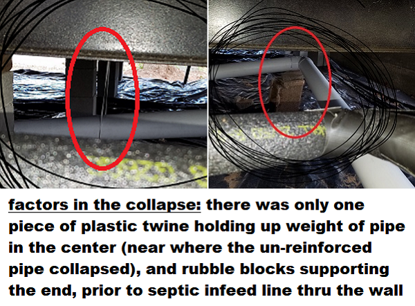

    drain to septic collapse.png (429.67 KiB) Viewed 1765 times
    unbelievable !
    drainage collapse details.png (411.65 KiB) Viewed 1765 times
    no wonder it fell apart

  • The errant contractor returned at 0845 this morning, after dropping off some proper pipe, unseen, late last night, in the rain. I crawled under the house to make sure that he used the right fittings, and correct glue for the pipe (my recent research into the subject, anticipating my having to fix it instead, schooled me somewhat). And, I made sure he suspended the pipe under the house with strong, large tie-wraps, that can fully support the weight, from the steel frame (it is a double-wide, you know). I'm going to use cinder and square blocks under it all, as insurance against one or more straps failing (which they probably won't do). I'll support it at each joint and connection, as well as under long runs, probably five places in all. I believe in overkill.
  • I believe he was being honest with me, when he said he thought it was done right, by his assistant, before he left that last day. He turned over all the underhouse work to the assistant, while he did the electric work, but never inspected what the helper had done (he had a big-money project nearing deadline, 60 miles north of here, so he was on the phone all day, and hurriedly rushed there after my house was supposedly finished).
  • He had done the electrical service mast install as he had done them previously, when he lived in rural Utah, so I learned. This was his first one in Texas, so he really didn't appreciate our urban (semi-rural) big-city electrical codes, and that was where my insistence on certain items wasn't followed. He left when I said that I'd take it from there on. But, relying on his underhouse assistant to get the plumbing and waterlines finished, without checking on them, is where I fault him. Inexperience, trying to work on too many jobs simultaneously, having unreliable help (that's why I had to help him on the wall build, no help showed up), and failure to communicate with/please the customer before calling the job complete, are all things he better get right in the future, before he promises the moon to the next customer, and only delivers green cheese, instead. I believe he will learn the ropes, and get better, but I really wish that my house project wasn't early into his learning curve, like it seems to have been. I won;t use him for two future jobs that had been offered to him, but I made sure he knows that if any other problems associated with his work EVER crop up, he better come immediately, with experienced help, to permanently fix them.
  • You might ask why we were so willing to let him try to get it right? I still like the kid, and our failure to find contractors willing to show up (remember, or maybe I didn't relate this on the forum, I had 6 EACH, of electricians and plumbers who said they'd come out, to at least bid on my project, but never came, and never returned my follow-up calls), made me doubtful of a timely fix by another, any other, professional. My wife had already scheduled her co-workers (the moving and packing crew her company employs) to come tomorrow to move the rest of the heavy furniture into the new house, on our dime. And, supposedly her sister and her nieces (w/their husbands, and the elderly parents, too) are coming later tomorrow, to help unpack boxes, arrange things, and probably just stand in the way. So,we needed to be able to use water and plumbing, and if the contractor didn't do it today, I (and my neighbor) would have to fix it tonight.
  • Now, I've just re-scheduled our AT&T tech visit, to install the telephone/router box on the outside of the new house, for the fourth time, having been delayed by contractors in the way, and no electricity present, the other three times. Before 1600 today, they say. So, my trip to get a propane refill for the trailer (I figure I, and the dogs, will be out here for up to a week, or at least Monday, before things in the house are so arranged to be dog-resistant, so I need more propane for the water heater and fridge in the TT), and concrete blocks for the patio extension and septic pipe support, will be delayed 'til evening or tomorrow. It's always something.
