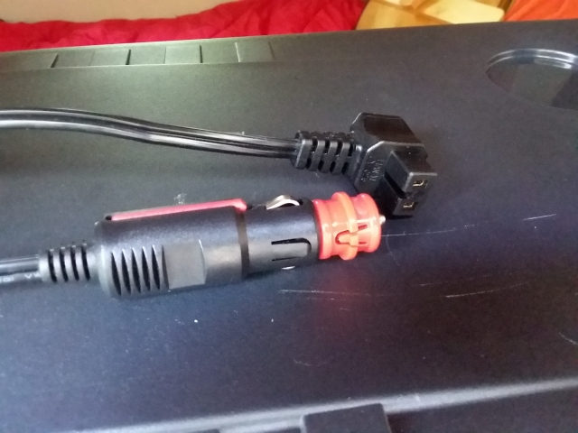

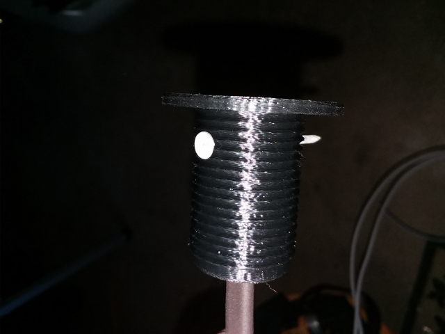

TimC wrote:So I went from this factory plug to a suggestion to rewire it.
Alpicool factory plug

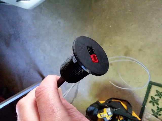

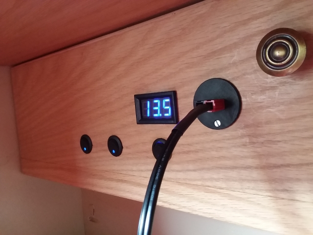

I used Anderson Powerpoles and I'm very happy with them. A set on the end of that cord above, and a mating set on the short pigtail I cut off for other uses where all I have is the old standard 12v socket. I wanted a mount for inside the cabin (traveling fridge power) and one in the galley. I found a guy on ebay that custom makes panel mounts. He had on offer one to fit a single set that mounted to up to about 1/4" thick panels. I asked him about that and overnight he made me a set for 3/4". Got them yesterday and mounted them. Very nice. I'm guessing they are made on one of those newfangled printers. I added the small, countersunk screw hole on the front. Not sure it was necessary though.
I just use a 4 penny box nail to fix the pulg in the mount. Easy to remove when needed compared to APP's roll pins. This is prior to filing a flat spot for the nail head and cutting the nail just short of the threaded body.

What did you pay for that? I have switched to Powerpoles for most electrical connection. I really like them but not the cost of what some items cost.

Postby TimC » Tue Aug 27, 2019 9:09 pm
Todd
Todd,
The guy's ebay handle is "thecrazyham". He is from Minnesota. Here's the item. He makes these and possibly other items. He made mine custom length for 3/4 ply. I paid $11.48 shipped for two of them. I hope he can help you out.
For one panel mount for 1/2" deep panel (he says he has mounts for up to 1" deep material)...
https://www.ebay.com/itm/Threaded-Panel-Mount-for-Anderson-PowerPole-PP15-PP45/173827149991?hash=item2878e7d0a7:g:8aMAAOSwv~xXEHPW
Four of the above...
https://www.ebay.com/itm/4x-Threaded-Panel-Mount-for-Anderson-PowerPole-PP15-PP45/173869926018?hash=item287b748682:g:8aMAAOSwv~xXEHPW
Looking through his offerings I see he has a mount for 50a (SB50) also. I may just have to order a couple of those for my solar inputs.

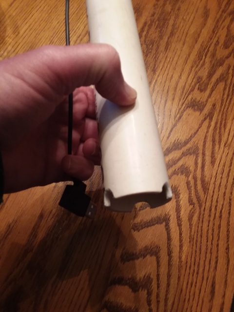

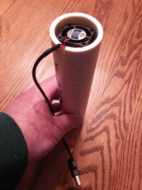

I've experienced the temp gradient in my loaded 12V fridge with 30 degrees at the bottom and 48 on top. Based on TimC's work with a USB fan and PVC pipe, I worked up a version today. A prototype has been running for 2hrs without any issues. The fan is mounted just above the holes on the bottom. I'll let it run a few days..hopefully..
I went with a 30mm fan and 1.5 inch PVC pipe(just nicely fits). The fan pulls 0.1A and puts out 3cfm. Power is a 10000mah power bank to yield 100 hrs of run time. I figure, while camping, I'll let it run all day and shut it off at night..should last about a week..if it all works.

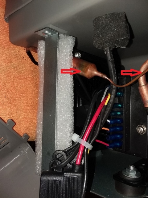

I've been trying to do a test of amp hours used by my Alpicool fridge, however, for various reasons I have had to disconnect the power every few days putting an end to my long term data collection efforts. The best data I can put together only spans 58.33 hours with 33.9 ah used. That comes to less than 14 ah/day. Not too shabby for efficiency for an inexpensive (relatively) fridge. I've had no problem with maintaining a full battery charge (144 ah and 200w solar). This data starts with the fridge already at a set temp of 32 degrees and outdoor temps in the low 70s and 50s at night. Obviously, YMMV!
Any fridge technical info related to the following is appreciated... especially the "OMG what did you do that for" type :frightened:
The fridge did develop an annoying little rattle that I wanted to fix, so, I took off the shroud covering the compressor to take a look. It was just five screws and the shroud comes off with enough slack on the wire for the power cord receptacle to move it out of the way. I know nothing about fridge compressors or how they work, but I did discover a couple of possible reasons for a rattle and was able to take care of it easily. The photo includes two red arrows. The left one shows a piece of foam I added between a copper tubing device and the fan frame (the angle doesn't show the foam on the other side between the frame and copper). The right arrow shows another section of that copper that was touching a larger copper tubing coming out of the compressor body that is capped off. A better photo, which I somehow lost, shows the same copper tubing farther to the right touching the cold copper line coming from the compressor. I carefully moved the small line away from those other lines and added the piece of foam to keep them from rubbing/vibrating against each other.
It was a simple fix, but, I am not sure how warm the tubing might get while operating. I ran the fridge from 59 degrees to 24 degrees checking for heat every few minutes and the small tubing never got hot. It was just warm to the touch. While I was in there I insulated the cold tubing that comes out of the compressor body as the total length was maybe ten inches and only about four inches had an insulating cover on it.

Postby fishboat » Mon Sep 09, 2019 6:04 am
I was up in Sylvania Wilderness a few weeks ago with similar temps..60% shaded site, low-high 70's by day and low 50's at night. The fridge was the only significant use of power. It pulled an average of 0.61A/hr..similar to yours above (0.58). At this rate I'd have a full week of a running fridge without a recharge, 7.9 days actually(115AH to play with).
I have another couple trips coming up. I've installed the fridge fan. I tested the setup at ambient and in the home-fridge for about 18 hrs total..seems to work fine. I'm thinking of running the fridge fan during the day and shutting it off at night. It would be nice to find a usb programmable timer so I could cycle the fan on and off as it doesn't need to run continuously...been looking and haven't come across one yet. We'll see how the temp gradient does in the camper fridge soon.
