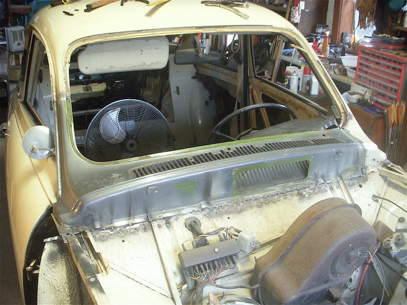

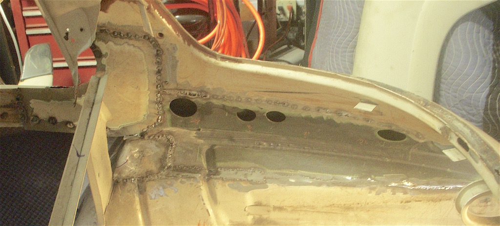

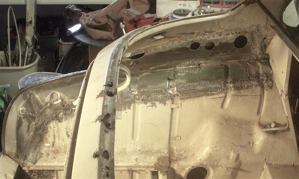

Thanks Roger , we’re doing something like that … We originally were having blowout problems , but increasing the wire speed made everything better … here’s a sample of our Franken-welds ( before grinding, we’re waiting for the big cleanup )
The little machine is working fine once we got it set right and had a little practice . ;)

We got all the welding done on the car ( a good bit ) , went through a small roll and large roll of wire , and everything worked out fine until the very end , when we had an incident of the wire not feeding ??? :o After checking out a lot of videos on the subject , we found out the trigger was “sticky” and sometimes had to be pressed twice to operate . So not bad considering we made a gazillion spot welds on that thin sheet metal . As far as I’m concerned the welder paid for it self , so it's all good ! 8)
The welds weren’t pretty , but did the job !!! :thumbsup:
And now , after all this welding practice , we have a new confidence to make some trailer mods on the next trailer build ! Knowing how to weld is really a game changer , opening many new possibilities . The HF machine just was a cheap way through the door . :thinking:
And the little Car is coming along . ;)
