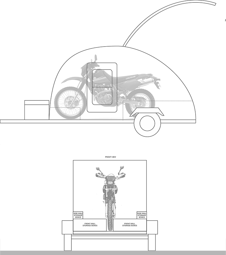

I've been trying to come up with an design for a small bike hauler (dual sport moto) based on similar designs. Haven't gotten it figured out yet but I'm loving the modular designs you've shown. Now to head back to the beginning of this thread and continue reading thru.
I think something like this might work with a 5' height. Basically figuring a 5 x 5 x 10' should fit the bike.
I know nothing about what a "dual sport moto" is, but Google search helped me find out... so I drew this 5' high x 10' long concept. It uses the TrailTop teardrop parts because that's the example you used, but sized as you said. I believe the bike is scaled accurately, the rear wheel on this one is 18" so that's how I sized the bike image. I put a 4'-high door in the side of the trailer figuring it might be nice to get inside to the front of the cargo area. It's got a teardrop-style rear hatch above a drop-down tailgate, and you'd use a ramp against the tailgate to roll bikes in. Not knowing anything about moto bikes I don't know if this concept makes sense.

That's pretty much what I had in mind. Thanks for taking the time to draw it up. The bike is 4'7" at the highest point (mirrors and windscreen) and about 7' long so with the hinge at the top like you show it'd fit. It's going to mean rolling the bike in crouched down which is something I'm willing to deal with. I could just go the easy route with a 6 x 10' cargo trailer but the lower more aerodynamic trailer you show will tow much better behind my minivan.
My one concern with using the teardrop design was if the walls would be supported well enough without a galley in the rear. With the traditional plywood build I think that could be a problem. Would your framing make that a non issue? If so when will I be able to buy the components?
Here's what I originally had planned (5 x 5 x 10') but I like your boxier version better since it'd provide more head room and interior space.

Ride4321 wrote:That's pretty much what I had in mind. Thanks for taking the time to draw it up. The bike is 4'7" at the highest point (mirrors and windscreen) and about 7' long so with the hinge at the top like you show it'd fit. It's going to mean rolling the bike in crouched down which is something I'm willing to deal with. I could just go the easy route with a 6 x 10' cargo trailer but the lower more aerodynamic trailer you show will tow much better behind my minivan.
The TrailTop components provide plenty of strength and rigidity without extra framing. There are a few wood cross-ribs in the roof of the teardrop below, but there's no galley and the sides are only plywood framed by the TrailTop fiberglass components.

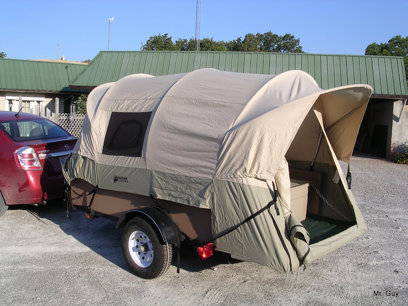

Postby greygoos » Sun Jan 14, 2018 8:59 am
You sleep platform is great. I was planning a spring build with something very similar but that could folded up and pulled by a small vehicle. By combining your explorer pod and possibly a truck tent or Popular mechanics car top sleeper. I dont have enough computer skills for an illustration. The idea being a 5 x 5 explorer pod with no storage inside, topped with a truck tent. When opened it becomes a queen sized sleeping area with standing room on one end.
truck tent.jpg (169.75 KiB) Viewed 3576 times

Postby jscherb » Sun Jan 14, 2018 10:16 am
greygoos wrote:You sleep platform is great. I was planning a spring build with something very similar but that could folded up and pulled by a small vehicle. By combining your explorer pod and possibly a truck tent or Popular mechanics car top sleeper. I dont have enough computer skills for an illustration. The idea being a 5 x 5 explorer pod with no storage inside, topped with a truck tent. When opened it becomes a queen sized sleeping area with standing room on one end.
Thank you. Your idea looks like a very good one, good luck with it.
