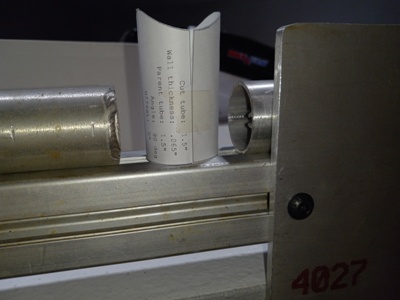

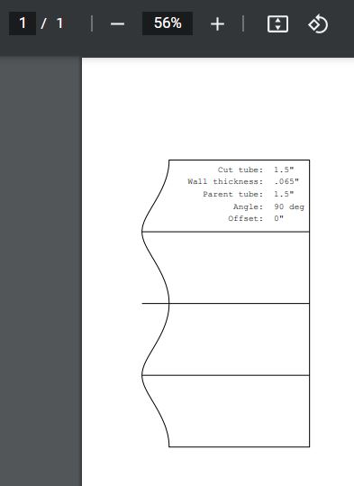

All the sudden I want a fat tire mini bike again :roll:
Today I dug up a pattern profiler!
Thought I would share!
https://metalgeek.com/static/cope.pcgi
I need to make some tube fit tube at 90 and some other angles to join and weld together, I will be cutting by hand; hopefully not my hand.
Not responsible for; connected to, giving demonstration's, lesson's, or selling squat :stompspam:
Done with PDF Printed @ 100% Posted JPG @ 56% (Very Accurate / G code as well)

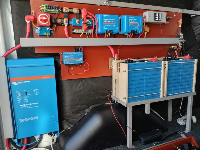

The van DC side is almost done, all the controllers are programmed and talking to each other. I still have some control wiring and wire management to do. Tomorrow I start working on the AC distribution, hopefully I can start charging the batteries by EOD.

bdosborn,
WoW! That looks great! :thumbsup:
What is the:
1. Gray square unit on the upper right?
2. Blue rectangular unit just to the left of the left charger controller?
3. Blue square unit just below the red cut off switch?
Thanks

Wow.. very nicely done. Victron is the best stuff and your work looks so professional.
How many aH of batteries and watts of solar panels do you have?

featherliteCT1 wrote:What is the:
MidNite Solar Baby Box Enclosure for 150V DC circuit breakers. I went with the real deal PV circuit breakers. They're not that expensive and you don't have to worry about what your panel voltage gets up to with them.
Victron battery protect for the DC/DC and PV charge controllers. The BMS I'm using will disconnect the chargers via the battery protect when it gets below freezing or if a cell voltage goes wacky or too high.
Victron battery protect to disconnect the DC loads from the battery if the voltage goes below 11.5V.
The Cerbo GX unit networks them over the internet so I can sit on the couch and see what the electrical system is doing. :beer:

flboy wrote:How many aH of batteries and watts of solar panels do you have?
Those are 200 A-H CALB cells in 2P4S, so 400 A-H total. I'm going with 620W of Newpowa solar panels: two 210W and two 100W. The 210W will be in series and controlled by the Victron MPPT but the 100W panels will be in parallel and connected directly to the battery via a switch that's controlled by the BMS. I'm experimenting with a new type of PV controller that's supposed to be more efficient as it doesn't do any conversion of voltage. That's why I'm going with the Newpowa panels, they have a MPP voltage that's low enough to connect directly to the batteries. Hope it work. :worship:
really nice layout, Bruce. I get really inspired looking at other's Victron components. I'll have to wait to put my components into action.... but between you and lfhoward I'll have a lot of good reference material to learn from :)
