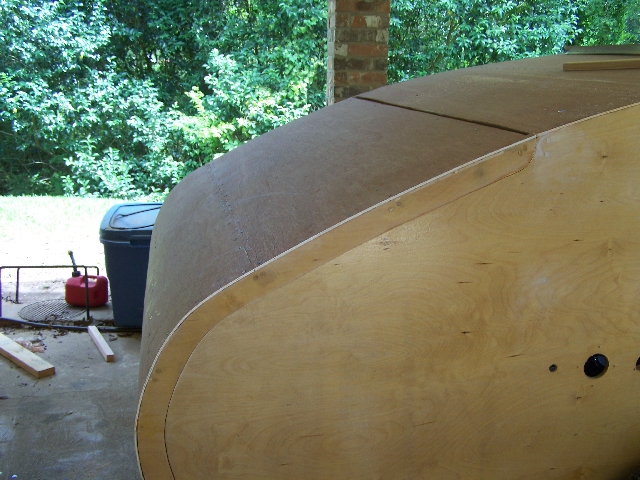

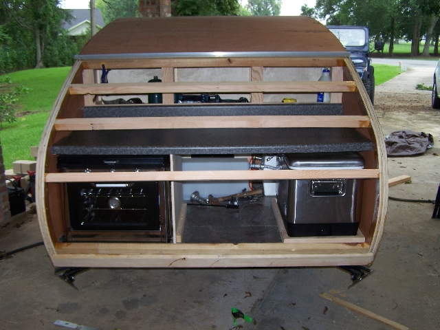

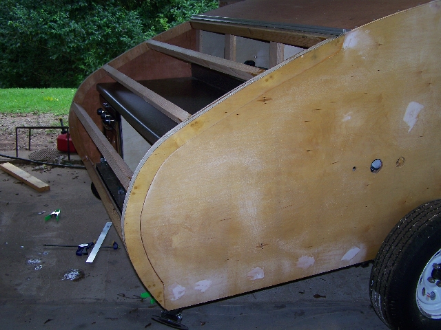

Postby Eddielbs » Tue Aug 12, 2008 6:44 pm

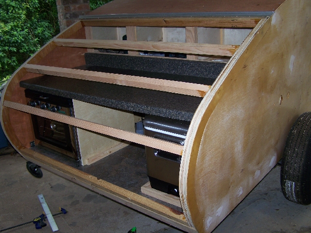

Got my hatch framed out today.
I may regret going with horizontal ribs later due to spring back but I have been preparing the skin i plan on using on the hatch like this..
I have wet it with hot water a few times today and plan on letting it set for a few days like this before installing it. Hopefully that will help with the problem.

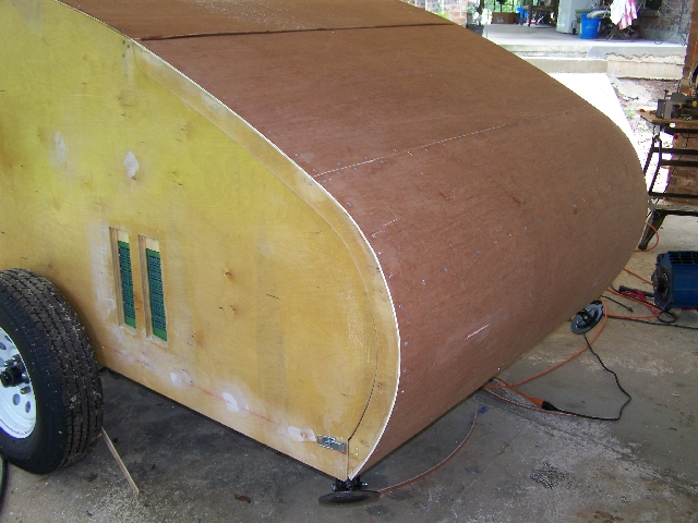

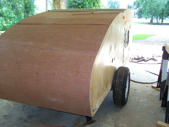

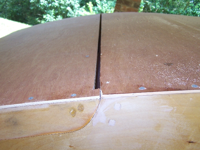

Postby Eddielbs » Fri Aug 15, 2008 1:34 pm
Hatch is skinned!! man that was a monster.. At least in my head i just knew it was not going to fit after i skinned it. Its on and I'm pretty stoked at how it fits. I'm still keeping my fingers crossed that it doesn't leak.
