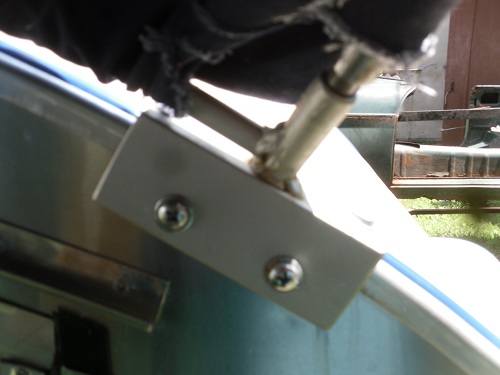

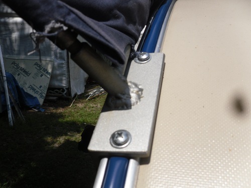

Postby pawp » Mon Aug 13, 2012 12:08 pm
Here are the brackets. BTW I am set up with poles and guy wires for high wind , just haven't needed them yet. The only problem I have now is that it sags between spars. I am working on a snap system that may solve the problem.
