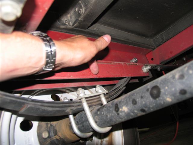

I had a HF trailer problem. Well it was really more of a minor issue. Okay, it was just a little ding. I pulled it over 5 miles or so of wicked washboard and a u-bolt dinged the frame.
My solution? I slowed down. I noticed a long time ago that the most vocal critics of the HF trailers are the people who have never used them. :thinking: Now that I've built a frame I'd use a HF frame again in a heartbeat. Saves a ton of work.
