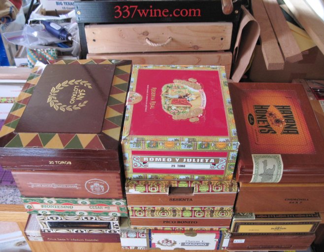

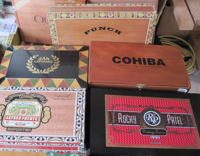

My box sources range from free to $2. The stash is running kinda low but I promised myself I would not buy any more until these were used.
I'm starting to get the shakes, though. :lol:

Hi Gary, thanks to you.... I am addicted and will contend that I do not have a problem.
You have some beautifull boxes there.
I suspect you guys have a lot more to choose from.
