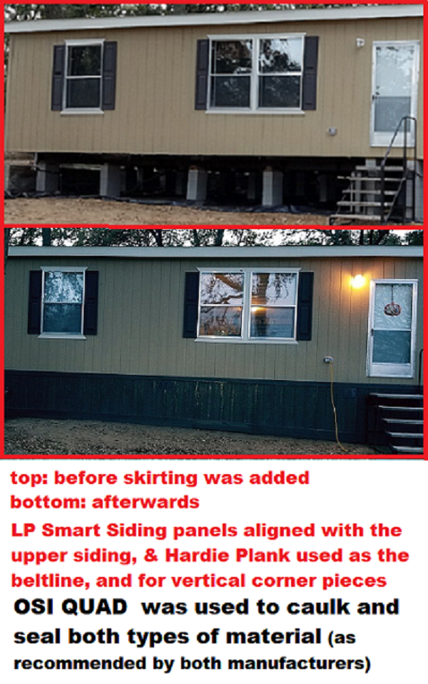

  • M.C. sent me some good info regarding the installation of my house skirting...what is good and what is not. Unfortunately, having already signed a contract about the skirting (included in the overall contract for the house), I found I had limited say over any change in the scheme of things, so I couldn't follow much of Mr. Toyer's sage advice. But, I did persuade the contractor to modify the prescribed methods a bit, to sorta satisfy my wishes. We kept the seller out of the loop on it, because they insisted on his doing it "precisely" as they said. I had to argue with them, initially, to even allow me to get LP Smart Siding (the same siding the house has), over their desire to have me accept vinyl or metal skirting, which they were pushing. I coughed up a lot, to get my choice of material, but they retained control of the details of its' actual installation.
  • I'm a relative newbie at this house repair/rebuild/new build game. I really never took the time to learn the proper way to do things, but learned from prior experiences what can work, and what didn't. And, I now have learned that trying to change the way things are done, especially by the people I have had working on my house project, is a sign to me, that everyone has their own way of doing things, for better or not:
  • Case in point: my electrical/water/septic/concrete guy had his own ways to do things, and I had to repair/replace much of his work; and there's evidence that it might require a 50% replacement of everything he did.
  • Case in point: my demolition guy damaged my retaining wall and patio, and removed way too much soil. I've had to spend $7500 so far, to remediate the damage, with more to follow.
  • Case in point: the house delivery/set-up guy was going to do it his way, irregardless of my wishes, until I "sweetened the pot" at the last second, with $2000 more, out of my pocket, on top of the contracted amount. I understood this, at least, because I doubled the amount of blocking over what was normally done.
  • And most recently, today, a case in point about giving a little, and receiving a little, when the contractor is the middleman, caught between me and the seller/manufacturer (as in the previous case).
  • 1) I was able to get him to use treated wood under the skirting, as a sill, of 8" width instead of 6",
  • 2) got him to change the color at the last minute (after we saw that the previous color was all wrong),
  • 3) got him to use a caulk/sealant that I saw that was better than what he was provided, and
  • 4) use more caulking than usual, to ensure that no area was left open to water intrusion, than necessary.
  • The skirting contractor was amenable to some changes, but was unable to comply with others, due to the specific wording in the contract, and the coming final inspection/detail check by the seller/builder, who had contracted with him, and who supplied him with the materials (and 90% of his work). He could make no major changes, visible to the inspector (the office/project manager/bean counter). Some changes, like the color, could be made, occasionally, but not any as to other specs. I wanted a flexible caulk that would allow some movement between the two dissimilar materials used, and my experience with OSI Quad led me to read up on its' use on LP and Hardie products. It was favored by both mfg's, so he used it. He went to a local paint supplier, and had them mix a custom color for him, instead of the provided color. But, when I asked for flashing, he said that it was not an option, per the mfg. So, that's why the best alternative was the much better caulk. I made up for the differences, in cost and time allotted, by helping out, furnishing some labor, tools, and buying parts, as needed, but I got it done 90% of the way I wanted (my best % so far.) This guy and his helper were so amenable to pleasing my wishes, that I talked my wife into giving him the job of building our front deck/steps/canopy, after seeing photos of his past work. Maybe I found a good one here!
  • In my dealings with various contractors, I see some good, some bad, some just incompetent, and some trying to do it right. I wish I had had time to plan and research in advance of starting this project, but it was an urgent thing, so I couldn't vet or screen among many, but often had to accept any that actually showed up. And, in our blind rush, with blind faith, to get a house in a short time, we were "forced?" to allow the seller/builder to sub-contract a lot to people of their choice, not mine (but I really couldn't find the right people, anyway). I have found some good out there, despite my complaints, but not as much as I had hoped for. It is what it is.

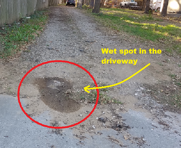

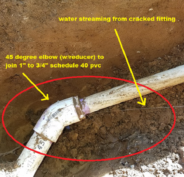

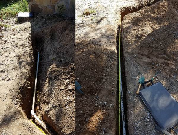

  • Another day (actually a week) goes by, another problem surfaces (literally). on Thanksgiving morning, when I drove my pickup down our driveway (to go to my in-laws), I noticed a damp/wet spot in the vicinity of our new underground waterline. My wife said that she saw the neighbors Mastiff dog there, so she thought it was just dog pee, so I thought it would be dry by the afternoon when we returned home . It was not. Since it was almost dark, I did nothing.
  • Next day (Black Friday), I dug down to the source of the moisture, before we left to get a couple of items on sale (I got a 20-gallon air compressor, she bought beaucoups more). I unearthed a leaking fitting on our newly installed waterline to the new house, buried directly under the driveway (precisely under one of the two tire tracks). It was streaming water, so I shut it off. I took a picture of it, and messaged my wonder contractor about the leak, forwarding the photo. H had promised to fix any further problems, ASAP, when he grudgingly repaired his collapsed septic feedline. I received no answer, so my wife and I decided to give him 'til Monday to respond, before we did anything to fix it. It was a holiday weekend, and many people are out of town, so we really didn't expect him to answer. The leak was so minor, that I could turn it on for washing clothes and dishes, and for showering, so it was primarily just annoying, not serious, yet.
  • Monday morning came, and still no response, so I decided to do the repair, myself. I tried to use my shovels, but found that using a claw hammer to break-up the compacted road base over the line was easier, and I used some gardening tools to de-trench the line, just enough to repair/replace it, without creating a huge hole. I used a knee pad to save my knees from contact with rocks, so it was hard work, but not really difficult. Since he had put one fitting directly under one tire track, I traced the next fitting to see where it was, and found it also directly under the other tire track path, another possible leak to come. And, the lines under the driveway were too shallow, at only a foot, with road base rocks pressing against them from above, though they were set in soft sand. I decided to remove all pipes under the driveway, replace them with thicker NSF-rated Schedule 80 PVC, and to bury the pipe slightly deeper, with concrete half-blocks surrounding the connectors, for protection from heavy loads. I also used larger Schedule 80 pipe over the connections to keep the concrete cinder blocks from abrading the new pipe. Sorta a pipe-in-a-pipe, inside a hollow block shelter. I also supported the blocks with rectangular blocks underneath. After enlarging/deepening/widening the trench, I used 4 "blockhouses" to protect the 4 new fittings I used, replacing Schedule 40 with 80, where the pipe was under the driveway. I used twenty feet of 1" Sched.80, and connected to the 3/4" Sched.40 pipe (feeder line from the meter) past the driveway, to make the critical driveway section all of the thicker-walled Schedule 80.

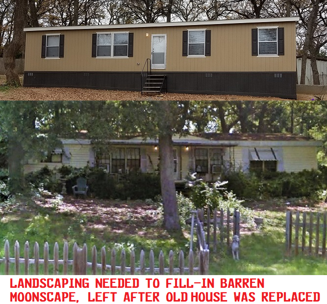

  • After two days in my "dog trailer", trying to combat the illness that I felt coming on, I felt good enough today to start moving the dirt. I made a preliminary yard sweep with the rake, to get a clearer view of the "moonscape" I have to level; it is going to take a couple more truckloads to do, that's for sure.
  • I constructed the critter barrier along the front and exposed side, compacted it by walking on it, and will add more as needed after a rain compacts it more. I also started moving rocks and larger chunks of clay over to the uphill-side retaining wall, and will finish that side tomorrow, with finer material on top, The remainder or the 10 cubic yards of fill will be gradually moved into place by hand, without having to use the wheelbarrow (5-6 cubic feet in a 'barrow is way too heavy for me, so I've been moving 3 cu.ft. at a time...makes a lot of walking). I'll have the next two loads of fill dropped closer to where I need them, and rent a Bobcat to finish it off. Screened topsoil will have to wait, but it should be easier to spread, without the big rocks and clay chunks to deal with.
  • The select fill will require a few heavy rains to finally settle in place, as will my two planned diversion channels/trenches on each side of the house. Water will create its' own path downhill, so I'll let that happen before I make clay banks and a gravel bed for either. Why fight nature?
  • I found a photo of the old house on Google streetview, and it shows how overgrown and densely foliated our yard was before. I would prefer the current "moonscape" myself, or to have it Astro-turfed before it becomes another nightmare of bushes, vines, trees, and poison ivy, that I had to remove last August-September, but the wife wants to try her hand at landscaping again, after neglecting it for the past 5 years. Time will only tell if I can keep her from over-planting again, or not.
