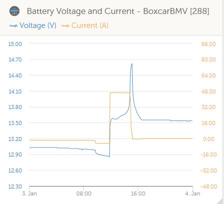

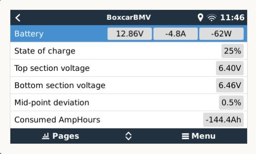

I finally got around to load testing the LiFePO4 battery. I used 144 amp-hrs and have a capacity of 180 amp-hrs so I discharged it down to 20%:
It only took 3 hours to charge it back up; it would taken half a day to completely charge a LA battery. I really like how the Iota charger works, steady 45 amp charge, tapers the current at the end when the battery reaches 14.6V and then floats the battery down to 13.5V.

Soory but how do you know your actual 100% SoC capacity if this is your first load test?
And why are you going so far up the voltage curve? Hope you don't plan to do that in normal usage, only point to hitting the max like that is when benchmarking SoH.
Link again to the cells, BMS / BM etc you actually purchased. . .
