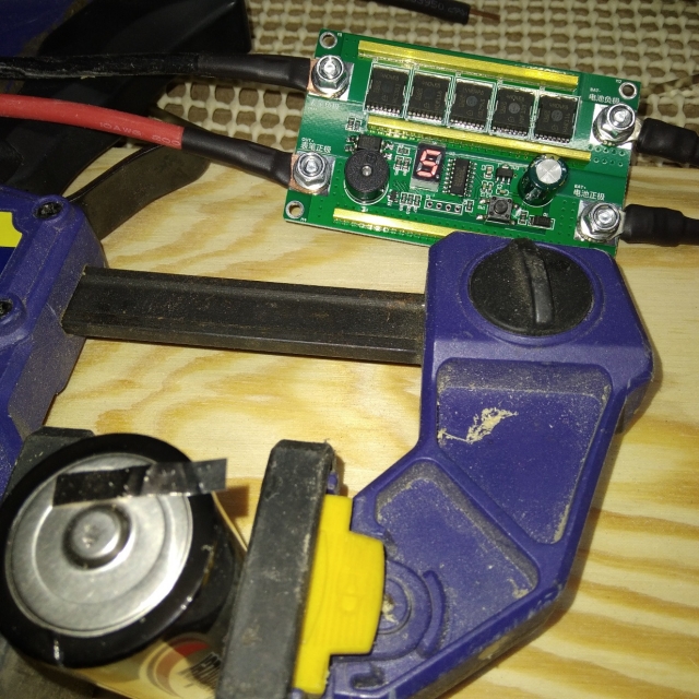

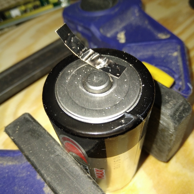

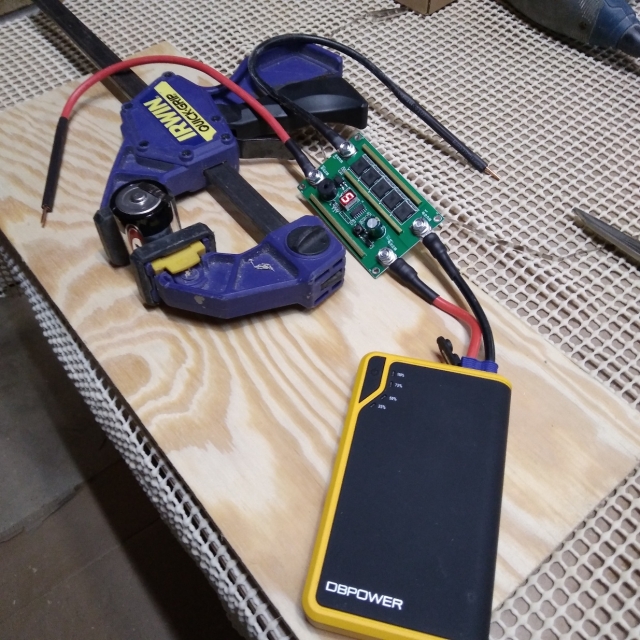

A week ago I ordered materials to put together a portable "Solar Generator". It'll consist of a 24 aHr 12volt LiFePo4 battery stuffed in a plastic ammo box. With Anderson Powerpole inputs and outputs, and a USB charging port. I wanted to create the bank using LiFePo4 6aHr cells and an inexpensive BMS. Welding the pack together seems to be the preferred way to "wire" everything together to make a 4S4P battery configuration. So I did some research on the tiny welders that DIYers use and purchased an ebay kit for under $20. I substituted an EC5 connector for the included ring terminals (intended for a battery post) and will use my car starter pack to power the welder. After experimenting on an old D cell to get the welding technique down. I am ready to go at it. Though I am still experimenting and would be reluctant to pass on much of my limited knowledge at this time.
Pictured is the car jump pack, the welding control unit, the welding tips (+ and -) and a D cell to practice welding nickel strips on. I donned a pair of safety glasses and a sheild. Yeah, I was a little nervous. I've found that it needs to be set at full power (there are eight levels) to weld the .015 nickel strip to the battery. After a few pull tests I realized that even though the strips were anchored to the battery I could pull it off with a little tug until I set the power to 6. I ended up settling on full power (8). I might file the welding tips to a smaller point to see if that helps get a better weld.
The welding control is kind of cool. You put the negative tip on the nickel and then place the positive tip a fraction of an inch away on the nickel strip. The welder must sense a closed circuit and it sends a momentary charge and then beeps. Then move the tips to another spot on the strip and repeat. Still playing with it to try to improve the welds but they are darn good after only a few trys.

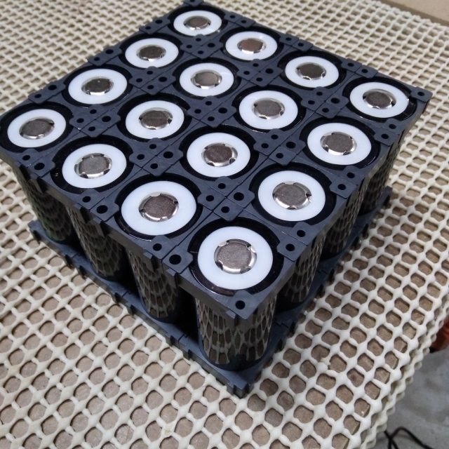

The 4S4P batteries in their holders ready to prep for top balancing.

Now just have to figure out how to top balance these. No matter how I look at it once I weld the nickel to the ends I won't be able to get them in or out of the holders to reconfigure to 4S4P. Hmm? Might have to do them 4 cells at a time and then I can just flip them. Any problem top balancing 4 sets of 4 parallel cells one set at a time and then assembling them? Should be close enough I would guess.

TimC wrote:Any problem top balancing 4 sets of 4 parallel cells one set at a time and then assembling them?
I would still top balance them all in parallel at once if you can. A good top balance will keep you from having balance problems down the road; I had to redo the balance on my first LiFePO4 battery. I just bought a 5A!!! active balancer but haven't had a chance to install it yet. Most cheap BMS balancers are in the milliamp range and only work when the battery is almost charged (so they don't work very well).
