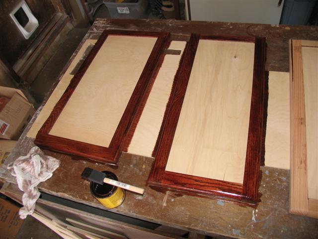

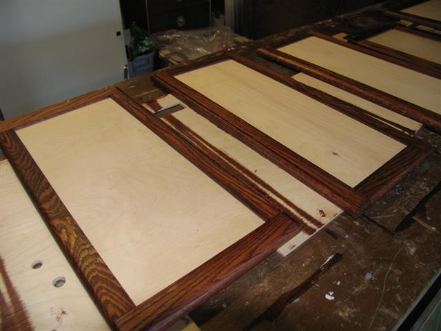

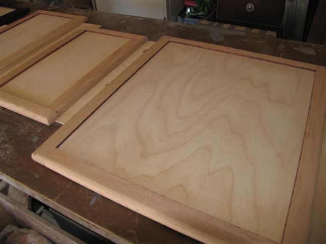

I've been working on the cabinet doors; rounding the corners, gluing and sanding (I hate sanding). I've got most of the doors done; now on to staining. I got the idea for staining just the frame from Doug Hodder and I have to say it sure adds a lot more work. But I think it looks great. Thanks Doug!
Pre-stain, notice I've already stained the inside of the stile and rails. I'm using minwax "Red Oak" stain:

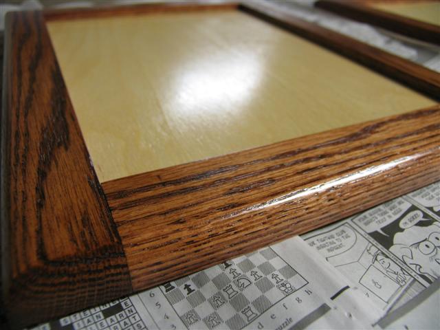

while the stain is still wet:
All stained, just need to sand a few little goofs off the birch inserts:

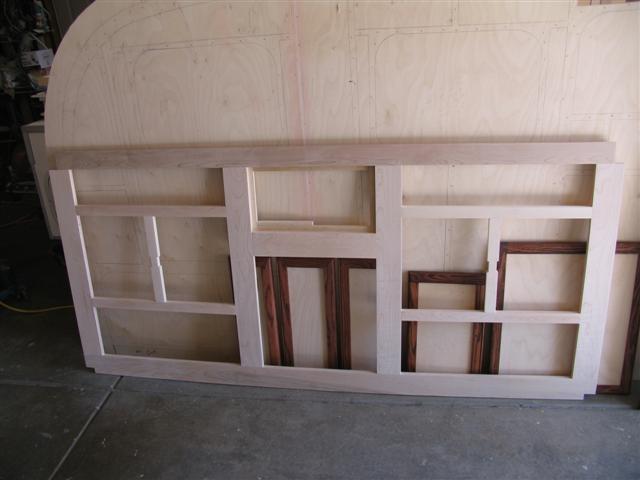

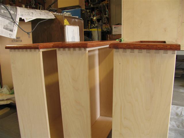

Its been slow going; I've been finishing the drawer fronts and cabinet doors for the front cabinets. Here's the frame for the front cabinets, glued and sanded.

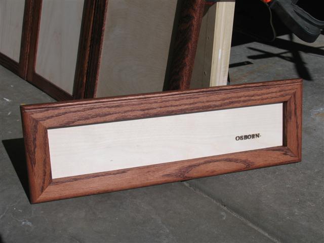

Most of the cabinet doors (the four for the front are still drying) and drawer fronts. The drawer front have mitered corners:
Jean laughed when she saw this drawer front but I think its cool. I found a branding iron on eBay of our last name:
Next time I think of making cabinet doors, they'll have mitered corners. A dado blade on the table saw and mitered corners is a much easier way to make doors. The drawer fronts took about a quarter of the time the cabinet doors did.

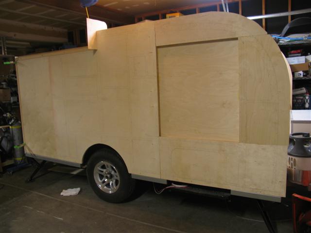

I framed in the wheel openings:
Now I can see the fancy wheels:

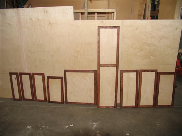

I was going to start skinning the exterior but it needs to be 65F for the contact cement to work properly so I moved on to applying the finish to the cabinet doors:
Boy I *LOVE* the HVLP sprayer from HF tools. It was really easy to set up and the finish comes out great. I'm using a water soluble poly so the clean up is even easy. Its the best tool since the pocket jig. :lol:

Nothing special, its a 120V oiless, 11.9 CFM with a 20 gallon tank. I have the pressure turned down to 60psi at the compressor and 40psi at the sprayer. I can spray a single coat of Minwax Polycrylic on 4 cabinet doors without the compressor kicking in so the sprayer doesn't use much air. I'm not thinning the Polycrylic, I just dump it in and spray. I do have to sand between coats to knock the rough spots down. Three coats is about right, four coats is starting to look a little thick, depending on how thick I spray each coat. I'm spraying the cabinets while they're laying flat on the bench and I haven't had a drip yet. I might have more trouble if I was spraying them with the face perpendicular to the ground.

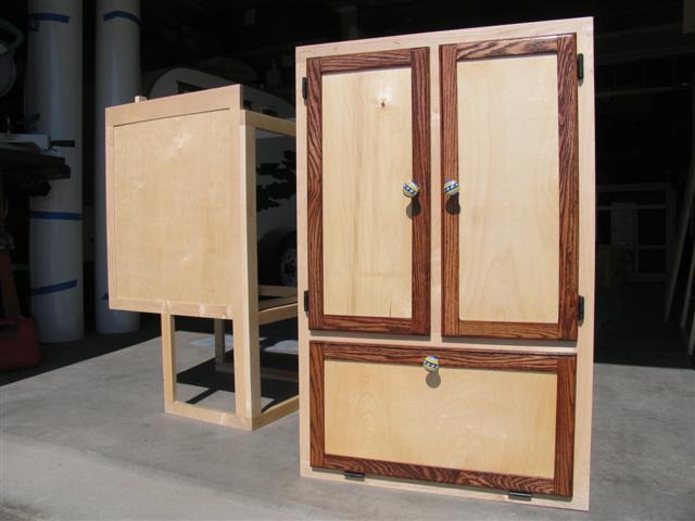

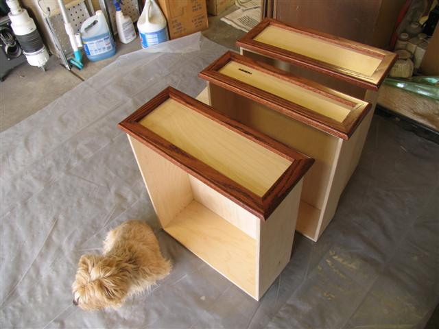

Arrgghhh, 4 straight weekends of bad weather. I won't be skinning this weekend as its too cold. I'm about done with the finish work though so here are a few pictures of the cabinets and drawers again...

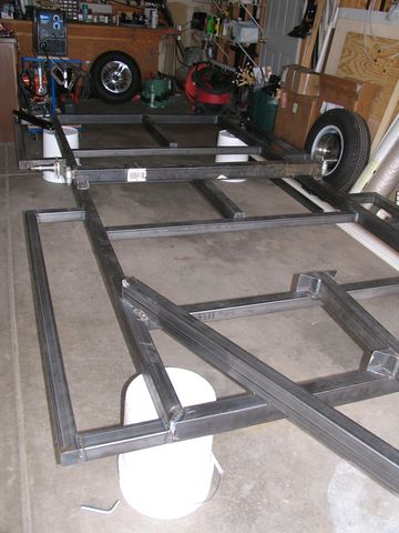

Postby wlivesey » Sun Apr 26, 2009 6:54 pm
Hey Bruce, What size box did you use for your frame? It looks like 2x3 with 2x2 for the cross members and wings. How thick did you go?
Look'n good!!!
Thanks! Bill
wlivesey
Posts: 469
Images: 283
Joined: Sun Aug 12, 2007 1:22 pm
Location: DFW, Texas
Postby bdosborn » Sun Apr 26, 2009 10:09 pm
Bill,
I used 14G for the frame (2x3 and 2x2s) as that was the thinnest I could get around here. The tongue is 1/8" (11G?). Been so long now I couldn't remember what I used and had to look at an old thread :o
There's definitely more flex than I expected standing on the rear bumper but I'm hoping the walls will stiffen everything up.
