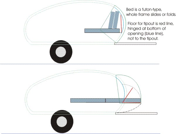

Postby navigator » Mon Jul 14, 2008 10:20 am
You mean like this?
See whole thread here: http://tnttt.com/viewtopic.php?t=21456

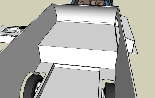

I had a chance over the weekend to play a bit in Sketchup. A few posts ago I talked about a standie based on the Escape hatch. Well, this is what I have in mind (the concept).
An escape hatch/Kampmaster/Winter Warrior with a foldout on the side of the bed (on the side because it's easier than the curved front), as well as a slideout for the kitchen on the other side.
With something like this one will certainly save a bit on fuel!!

Postby mikeschn » Tue Jul 15, 2008 10:13 am
Very nice design Barrie,
That's what I was trying to do with the optimized Winter Warrior. But the fold out for the bed and the slide out for the galley are really nice touches...
Postby Mark & Andrea Jones » Tue Jul 15, 2008 10:20 am
bgordon wrote:
I like it.
What about an elevated bunk bed on the right, so that it hangs out (or has a flip out section) over the legs / feet area of the main bed? Then there would be room for a third person or a small child.
And if the elevated bunk were over some cabinets, there would be room for clothes, camping gear, etc and it should still fit underneath the hatch when it is closed. Oh, and some skinny cabinets on the left side - maybe ones that are accessible from the inside or the outside of the TD for galley storage to supplement the slide-out that you have.

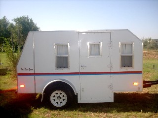

Postby mikeschn » Tue Jul 15, 2008 5:21 pm
Oh, that's not the "standie" design that I posted. That's an older design called the Optimized Winter Warrior.
I am still working on the Standie, with the shower and bath!

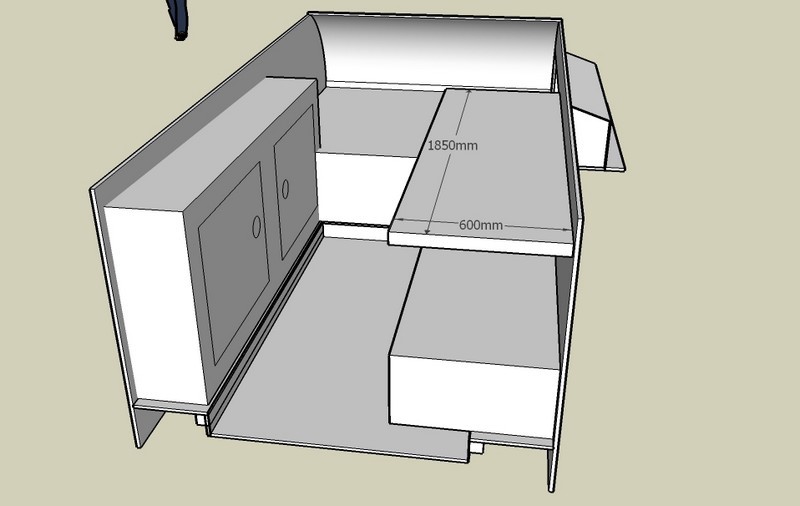

Postby bgordon » Wed Jul 16, 2008 3:02 am
Mark & Andrea Jones wrote:I like it.
Thanks!!
Mark & Andrea Jones wrote: What about an elevated bunk bed on the right, so that it hangs out (or has a flip out section) over the legs / feet area of the main bed? Then there would be room for a third person or a small child.
As a matter of fact, I designed the trailer so that one can put in two bunk beds, one on top of the other (I have two children). You don't need the flipout, because the beds can be standard length (1.85m or 73 inches). This is what it looks like when the beds are in place:
This means that there will not be any place for the bathroom :cry:

StilesMA wrote: Hey I like all the ideas, but what happened to the Shower/Potty Room.
I deliberately did not include the bathroom, because I wanted to test the concept first. But of course there is room for the bathroom! But then the trailer will be a two sleeper only... :cry:

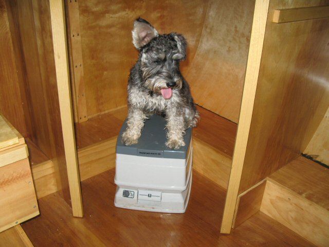

Back when we used to own a tent trailer we discovered we did not like to cook in the cabin galley. It was too cramped and the cooking smells kind of took over the whole cabin. I think a similar problem might arise with having a porta-potty in a tiny trailer. Depending on how small your trailer and what diet you follow, it could get kinda ripe in there.
The only reason I would want a toilet in a small trailer is if I was camping in a totally remote area and bathrooms were not available. Just my two cents. . .
