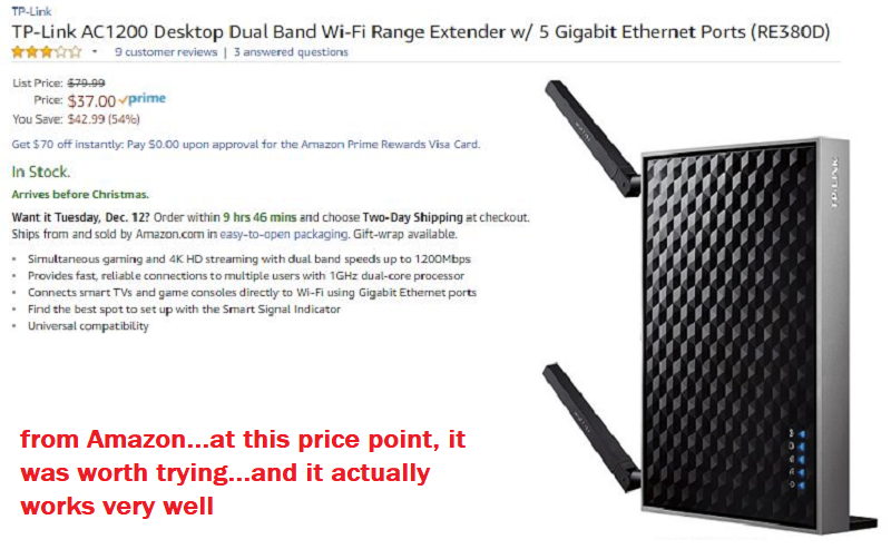

working on it wrote: from another thread... when we emptied the old house, we moved the wireless router into my 3-bay steel garage, just behind the trailer. Anytime we needed to use wifi on our phones (and later on our laptops, after we retrieved them from a storage pod), we had to open the garage door to improve our connection. That wasn't good, as we had furniture packed in the garage, that would get wet if it was raining, and we also needed to keep it closed when the dogs were loose in the compound (hazardous chemicals in the garage).[*]Once we had electricity hooked up in the new house, I had AT&T move the router back inside, into my new corner office/dayroom, and out of the metal "Faraday cage" garage. Immediately, my laptop in the trailer had a much better connection, and my new Samsung S7 too, though it still loses connections periodically. When using my devices, I sit at the trailer's dinette, where the streetside wall, refrigerator, and water heater block direct wireless contact with the router (which I can see thru the house window if I peer out the trailer window over the sink, a mere 65 ft. away). So, I just bought a wifi range extender (TP-Link AC1200) from Amazon, and I'll pair it up with the router, then put it in the trailer on the nightstand, where it will have a clear line-of-sight with the router in the house. It should help, if only for a short while....
  • I received it yesterday, and set it up after my back started giving out when moving the fill dirt. It took me three attempts to get it to link up with my router, using the WPS button on the router, and the RE button on the extender. Then, after pairing them, I took the extender to the trailer, set it up on the nightstand where it had only the blinds & window glass between it and the router in the house (blinds and window glass there, also), and not the aluminum skin.
  • My S7 phone immediately had a better wifi connection, as shown by a Meteor app speed test. where it previously only had marginal upload and download speeds, now they rate "awesome" or "very good" on the tests. Even though this is a just a temporary fix for my trailer stay, when I move it into the house, I'll put it in the central living room to make wifi reception stronger on the other end of the house. My next electronics purchase will be an AT&T Microcell unit, to get better phone reception (we only get one or two bars on our phones, and we've done away with our landline).
    range extender TP-Link AC 1200 (RE380D).png (331.98 KiB) Viewed 1993 times

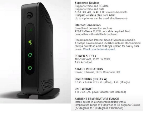

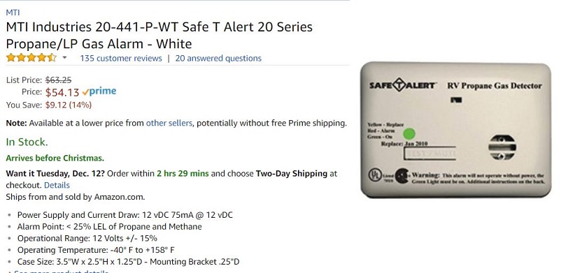

  • Propane gas leak detector. Good or bad, I don't know, but when it started sounding off, I turned off the gas and emptied the trailer of dogs. Even after 15 minutes, with no gas on, the door and windows open, and a fan blowing out the door, it was still sounding off. I couldn't reset or mute it, so I disconnected it, took it out to my truck, where I hooked it to the battery (12vdc sensor). It still was going off, 30 minutes later. Guess it went bad, seven years after the "replace date" printed on it. But, fearful of a gas explosion, I left the gas shut off, and still thought I smelled gas anyway, even when I went into the new house, which is all-electric...my imagination gets the best of me, again. I ordered a replacement sensor, to be here in two days; until then, no hot water in the trailer...just another incentive to get the fence up, faster.
    RV Propane Leak Detector.JPG (90.08 KiB) Viewed 1949 times
    should've replaced the old one in 2010
P.S., 12-12-2017 The leak detector has been replaced, and the gas turned back on; problem solved. Sure glad it was the sensor, and not an actual propane leak.

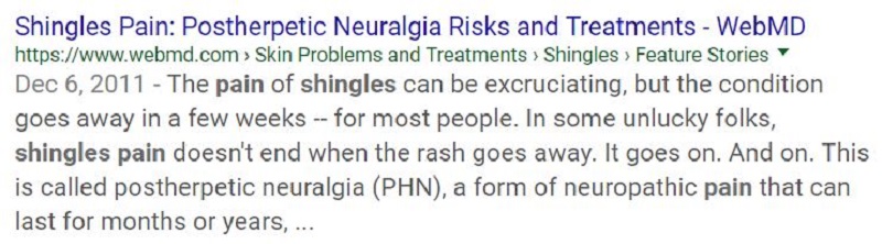

  • The shingle blisters have scabbed-over, but don't seem to want to go away. And, there are three very sensitive and painful areas that hurt all the time (causing me stress, and problems sleeping). They bother me more than when I first got them, so I'm worried that they may persist for months (I hope not...spring/summertime activities will be curtailed, if so).
    Shingles pain...forever..JPG (82.01 KiB) Viewed 1665 times

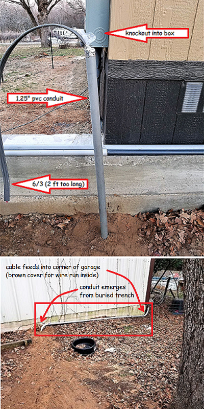

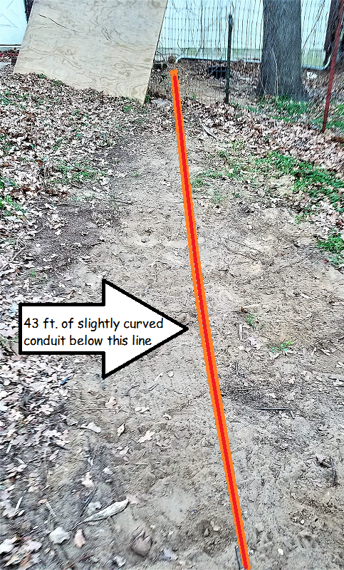

    .....part B: On a second sub-project, restoring power to the garage and sheds, I dug a 43+ foot long trench between my outside power box (200 amp service), and the back corner of the garage. The original owner of our old house had put a wire run from the garage's sub-panel down the corner piece of the metal garage, and had directly buried 12 gauge Romex in the soil, as the power feed to the 40 amp sub-panel. He had also directly buried another line to the old shed, also to another 40 amp breaker, but it ceased functioning two years ago, for unknown reasons. Not wanting to chance an underground break to the garage panel feedline, I chose to put UF-B 6/3 cable (w/ 10 AWG ground) inside 1 1/4" pvc conduit, and bury both as insurance against breaks (I'm always driving T-posts in, re-configuring the fences for various reasons...I once severed the underground telephone wire twice in one day; the PO had zig-zagged when burying it...). I bought a trenching spade, and I was able to dig a 43+ foot trench in record time, though carefully, inspecting each square inch J.I.C. the telephone wire was there (it took me twice as long to uncover the broken water line, 2 ft or so, using a hand trowel!), and over two more days I assembled the various cable and conduit pieces to make a protected feedline for my garage (I'll run sub-feeds to my wife's sheds later, from that panel). I bought a 75 ft 6/3 cable from Amazon, but bought NM-B, which my electrical engineer neighbor said would be fine, installed in conduit underground, but I reviewed the NEC and also some insurance claim rejections online, and decided to send back the indoor-rated NM-B, and get the UF-B rated for underground direct burial (I still fed it thru conduit as a fail-safe, in case anyone might dig in the yard, after I'm gone....). I pulled the cable thru the conduit (very difficult; I'll use 2" conduit if ever I do this again), cemented the pvc conduit and fittings, and buried them in place. Until my neighbor can complete the installation for me, as we had agreed/bargained for earlier (we've got a major deal in the works...cars and engines and trailers; him helping me, and I him), I temporarily semi-sealed the open ends of the conduit above ground. I've got 60 amp breakers for both panels standing ready (up from 40 amps...I'll be able to finally use my 220v stick welder, at last), and then it'll be on to another piece of the "new home project" puzzle.
    conduit & cable buried in trench.png (974.72 KiB) Viewed 1144 times
    conduit & cable end points.png (785.38 KiB) Viewed 1144 times
