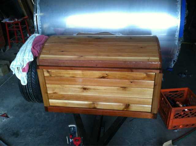

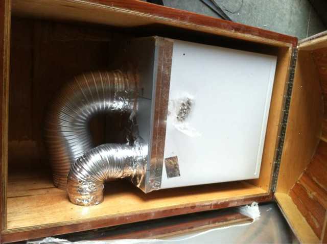

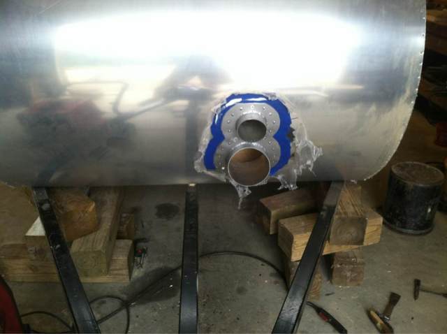

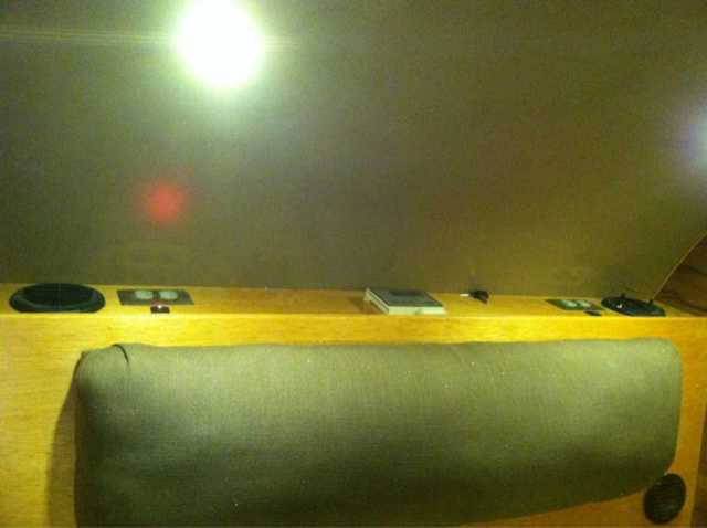

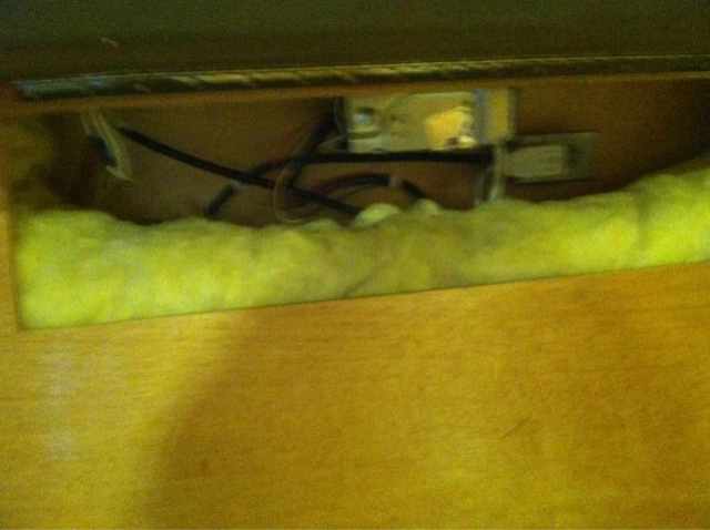

I have been building a tongue box for a 7k btu combo unit. I went with that size because it was the smallest available to me that had heat and air, and the cooling outlet in the corner of unit. This allowed me to have a flange face made with 2 outlets. One 4" supply and one 6" return. Extended the controls and ran them through my 6" return and it put it into the headboard and functioning plenum. Then the 4" charge line splits into 2 and comes out of the top of the headboard and allows air to fall down on us and the return air gets pulled in down at the mattress level. Pics to follow.

Postby Sputterputz » Sat Oct 05, 2013 5:37 pm
Promised pics
Sputterputz

Re: Pet Cool
Postby Sputterputz » Sat Oct 05, 2013 5:38 pm
Sputterputz
