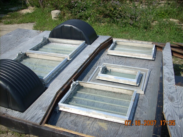

I had the idea to check out a recycling place in Lawrence the other day and came across an old TT with cool windows in it. I was able to get four good windows and an extra for parts. They sold by wieght, 44 pounds at 10 cents a pound. Now I can finish designing the frame work for the sides and get going on this thing.

Aunti M, there were a couple of other old campers there with windows still in them but none with the five panels. All but one of the screens were good also. Half an hour of sweat and $4.40 later I was real happy.

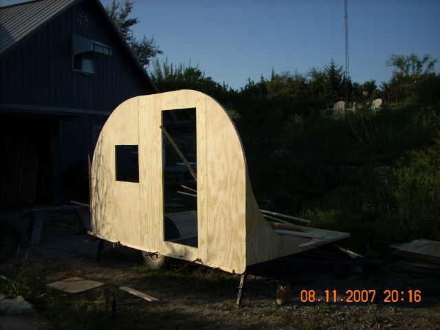

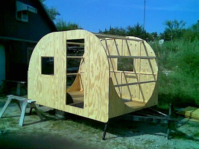

Postby 2old2tent » Tue Aug 14, 2007 7:11 am
The walls are up.
Ana one.
Ana two!
Maybe outer skin this weekend.

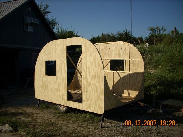

Postby 2old2tent » Wed Aug 15, 2007 4:44 pm
And then there were spars.

Postby steve wolverton » Wed Aug 15, 2007 6:53 pm
Looking good. :thumbsup: What size spars are you using?

Postby 2old2tent » Wed Aug 15, 2007 8:06 pm
Those are 2" x 2" 's Steve. I went with 1/4" ply outside, 1" x 2" framing and I will use 1/4" for the roof. The pop-up has a 4" deep perimeter frame and I have 3/4" ply for my dropped floor. That will give me a finished inside height of 5'-11 1/2". I'm 5'-10" so I will be able to just clear the ceiling.

Postby steve wolverton » Wed Aug 15, 2007 8:25 pm
2old2tent wrote:That will give me a finished inside height of 5'-11 1/2". I'm 5'-10" so I will be able to just clear the ceiling.
I really appreciate how thoroughly you documented the Puffin build.
I will come up with my own name. Can't steal everything from you, can I?
:D
Nice. :applause:
I only have about 1" of clearance when standing in my dropped floor, and it's plenty. I think you'll really appreciate the ability to change clothes while standing up inside your camper.
The documentation of the Puffin is a bit scattered at the moment. I was supposed to start cleaning it up last week, but never got around to it. I'm enjoying camping too much at the moment. :D
I'm enjoying watching your camper come together. I remember how exciting it was to get it into 3D. I'm guessing you're going to install the roofing next? Keep us posted!

I am using a 7 pain window from a 1955 Shasta I ripped apart over 25 years ago. I knew it might come in handy some day. It looks a like yours. :D I came across this sight for window parts that might be usefull. http://www.vintagetrailersupply.com/ I haven't ordered anything from them yet.

My windows have the torpedo cranks on them. I got all the good ones. Which was only one extra.
There wasn't any name on the old TTT that I got the windows out of, I should of gotten a picture of it and Gage or someone probably could have ID'd it.

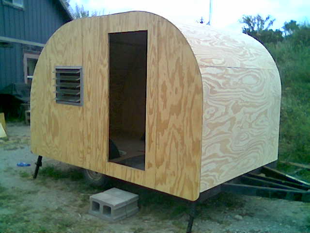

Postby 2old2tent » Sat Aug 18, 2007 6:33 pm
Got the roof on this morning.
I thought the safest place to store the windows would be the wall. Plus I wanted to see how they looked. What do you think?
Next will be building a bed frame and a door. So far so good. :D
