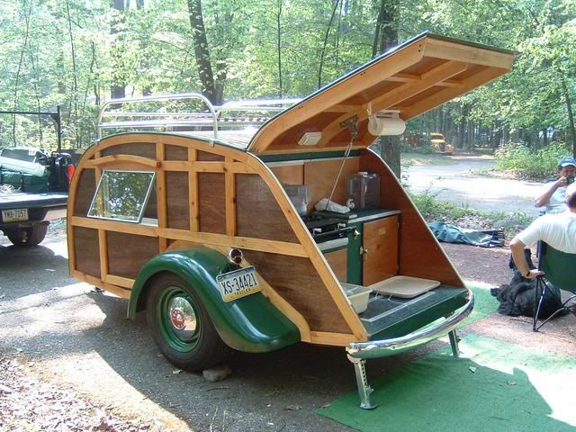

Postby bgordon » Wed Jul 16, 2008 3:39 am
Hi,
Here is an alternative idea for a side galley. :thumbsup:
Barrie

Postby SuperTroll » Wed Jul 16, 2008 7:31 am
Now me like the slide out Galley! the whole trailer ain't too shabby, I'm gonna keep that picture and try to think light and solid.....(don't mind the bed extension but I don't want it to be soft sided.....
THANKS!
