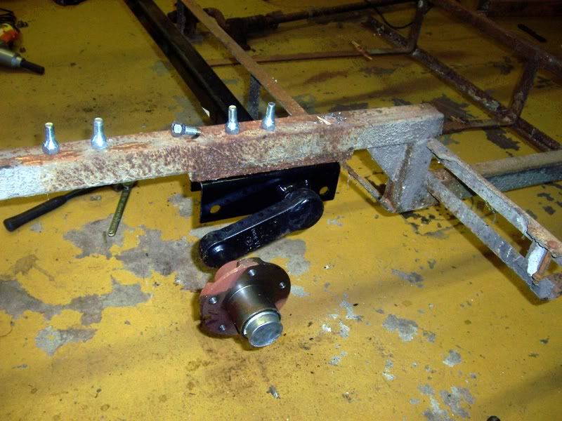

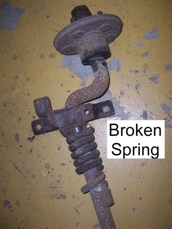

Its got a broken spring so its getting new "Torsion Axel" running gear.
Its going to go into the 60 degree range tomorrow so I'll probably start sand blasting and change out the Axle.

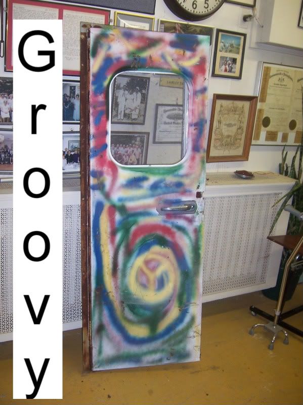

Pulled apart the windows, straightened them out and basically found out what I had. The door is shot but the frame and screen door are in tact. I have found a new/different door.
I'll have to make new jams for 1 of the windows and possibly a second.

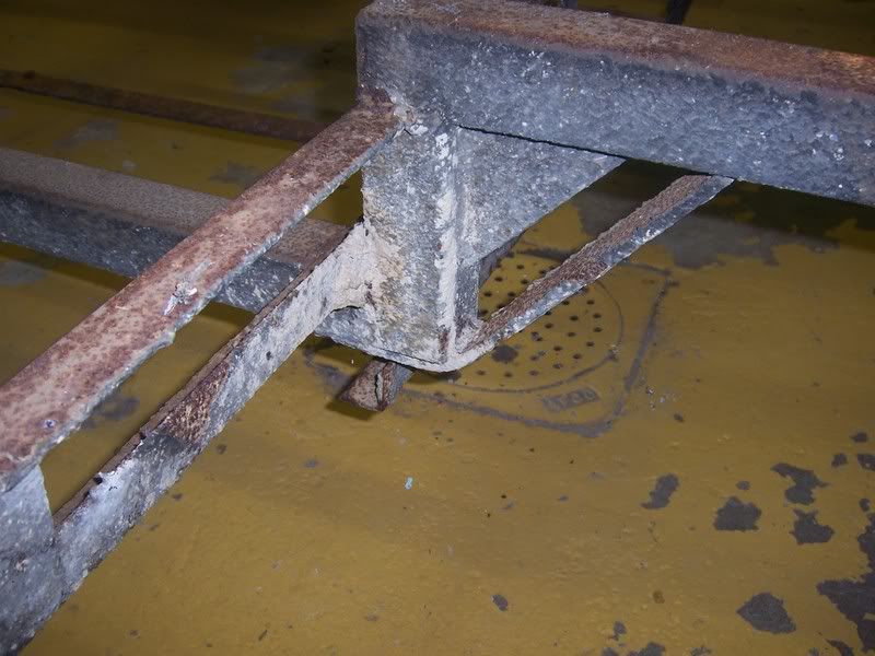

The Frame

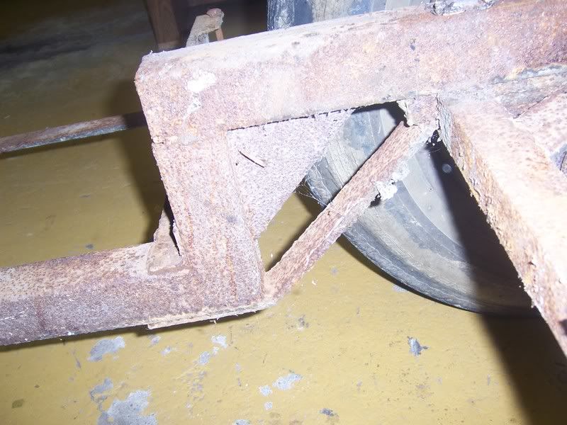

I was relatively impressed with the construction of the drop portion of the frame.
Some of the ones I have had a glance at were real crap..no reinforcement, "but to but" welds, But this has gussets and reinforcement all over.
I feel just a good cleaning, the new axle and tar coating will put this frame in good shape again.

Postby len19070 » Sun Dec 28, 2008 12:47 pm
doug hodder wrote: What specs do you think you are going to use on your axle? I'm thinking of a similar project, just haven't committed on an axle yet, have some ideas for it though. Doug
I had a 48" Torsion axle sitting around for years. Brand new, never used. I can't even remember what I originally bought it for.
But it's an off the rack Northern Tool Axle. (though now i would use one from Southwest wheel)
Its already on, all the dimensions were right and it fit like a glove.
All the labels and sku#'s are still on it.
I'll get them and pass them on.

Postby len19070 » Mon Dec 29, 2008 6:04 am
I did get the axle swapped yesterday.
The new axle has bolts instead of studs for the wheel lugs which I'm a little bothered about, but not bothered enough to do anything about it or make me say no to a Basically Free axle.
I'll live with it.
The original rims won't fit the new hubs by just a few thousandths so I'm going to turn them a bit today.
Then back outside to be pressure washed then in on Thursday for prep and undercoating.

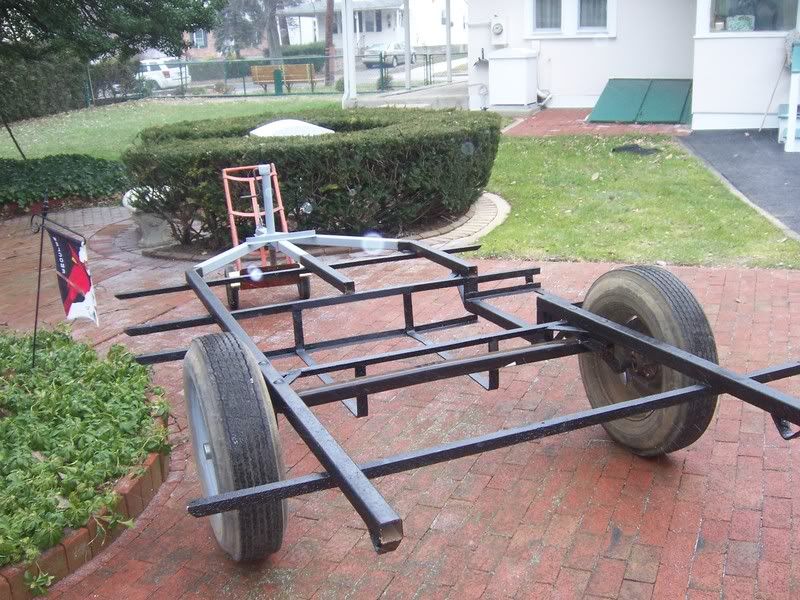

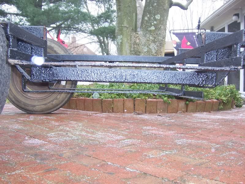

Postby len19070 » Sat Jan 03, 2009 12:07 pm
I got my frame in a decent condition this week. All sand blasted, cleaned and coated.
However when I installed the new axle I knew it would sit a bit higher.
Well it sits a bit higher than I want...which for a Scotty is not really a bad thing.
The step is just a little uncomfortable to step into...Sooo, since I have a "step up/step down" model I have decided to lower the step to the drop down floor level as I have seen on other Scottys.

Postby 48Rob » Sat Jan 03, 2009 6:40 pm
I think it will be a wise choice to drop the step to floor height.
There appears to be plenty of clearance, and as an added bonus of the new axle raising the ride height, you "could" make the dropped floor a little deeper...

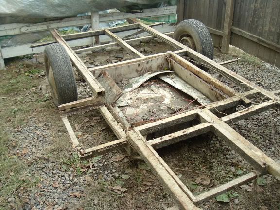

Postby starleen2 » Sat Jan 03, 2009 11:17 pm
I was admiring your work on the frame and a question arose. I see that the main supports of the trailer are ABOVE the truss mounts. How does the floor attach? are there spacers?
starleen2
5th Teardrop Club
Posts: 16272
Location: Pea Ridge ,AR

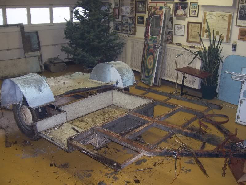

Postby len19070 » Sun Jan 04, 2009 7:13 am
starleen2 wrote:I was admiring your work on the frame and a question arose. I see that the main supports of the trailer are ABOVE the truss mounts. How does the floor attach? are there spacers?
Yep, its built up with 2" material then the floor is secured to that.
heres a shot while tearing it down;
Its tough in the photo to see the differance between the wood and the steel.
