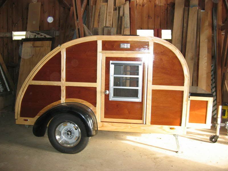

Has anyone made an awning ( for over the doors) that attaches to their tear without the use of poles? It seems that the poles and guide wires are always in the way. So I was thinking of attaching the awning with turn buckles to the top of the tear, through the grommets. Then make a frame, maybe out of conduit that would arch out away from the door to support the front of the awning. I found some handrail fitting for a boat that I could attach up near the top of the tear to hold the conduit frame. Then maybe a bracket coming off the frame to hold the bottom. Any thoughts would help. Since my tear is a woody I have 5/8" solid ash to screw into. Here is a profile of what I am working with.

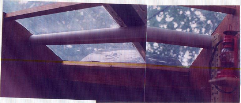

2 1/2 " schedule 40 pvc runs thru the trailer and inserted in it is schedule 80 2" pcv. It is quite stout and the telescopic feature is very quick to set up.
Pardon the bad photoshop effort but here is a look at the housing inside from side to side
A short section of 2 1/2 could be cut and split in 1/2 and a bolt inserted. With a few section of 3/8 or 1/2 pvc cut slightly over length and inserted over this saddle it would make bows to give the roof a rounded look.

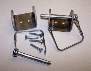

Shademaker has different awnings for RVs. They do sell a bracket so your pole can come back to your sidewall. Here's their description:
"Our custom fabricated aluminum brackets that let you mount the Supreme awning legs to back to the camper. These brackets are perfect solution for those times when there is no way to stake the legs in the ground or in cases when the ground is uneven. Our solution also gets the awning legs out of the way. Simply mount brackets on your trailer and drill small hole in bottom of each leg for pin to go through".
I think it can easily be adapted to a side wall for teardrop.

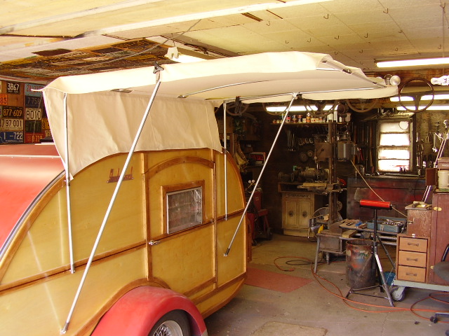

Postby TENNJIM » Wed May 06, 2009 1:56 pm
I saw a cantilever arrangement that used conduit pipe and pipe holders-four of them mounted on top of the teardrop (a woody). It could be installed on either side or both sides as a canopy or a privacy curtain thing. The picture may be in the recent 16th Dam Gathering photos, Southwest region.
