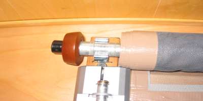

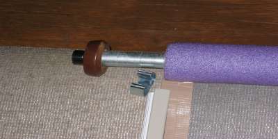

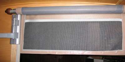

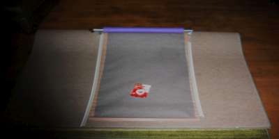

From the five minds of Mikey comes this solution to a screen door.
List of materials:
Sponge rubber pool noddle
Broom handle or equivalent
Screen material
Color matched duct tape
Double sided Scotch Mounting Tape
Broom handle clips
Thin metal bar to weight screen
Wheel knob for cranking screen up

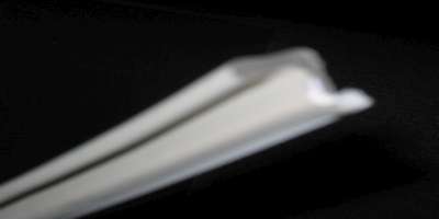

Vinyl weather stripping color match (Lowes)
Slide noddle over broom handle
Tape (double sided) weather stripping to interior sides of door frame:
Use duct tape to border screen for strength-two layers. Also tape thin metal bar to bottom of screen
Mount broom clips
Tape one end of the screen to noodle
Mount roller above door
Pull bottom of screen through the slots formed on each side by the weather stripping
Width measurement is critical; better to be too wide than too narrow.
Works good and is out of the way. One note broom handle clips come in three sizes; I found the larger ones to work best. I believe this application will work on most tears.[/img]

pics...

Postby ParTaxer » Sat Sep 12, 2009 12:47 pm
laoutdoorsman wrote:very interesting....do you have bigger pics??
Let's try these:

Postby ParTaxer » Sat Sep 12, 2009 2:09 pm
I thought of that including cutting out the middle and attaching the screen. The typical roller shade has a narrow tube and would take awhile to crank up. I looked on line for roll up screen shades that were retractable but they were expensive and tend to retract horizontally instead of vertical. I'm not saying it can't be done but you are still going to have to bind the sides of the screen and have a slot for it slide in. Else it would dangle and blow with the wind. I just installed the second side in just a few minutes.

Postby ParTaxer » Sat Sep 12, 2009 5:26 pm
I think what I had in mind is a breeze without insects. The weather stripping keeps the tension on the screen. I could't figure a way to have the roller shade and keep a good seal from mosquitoes. The door that I have on the TD has a curtain and the screen venting is sometimes inadequate. I thought of magnets but the door frame is aluminum. I didn't want to deal with velcro.

Postby 48Rob » Sat Sep 12, 2009 5:35 pm
Nice bit of thinking! :thumbsup:
What is the metal part at the top left, looks like a hinge of some sort?

Postby ParTaxer » Sat Sep 12, 2009 7:18 pm
That is a swing arm for my 15" LCD TV/DVD. Totally unrelated to the screens but had to be accounted for. Luckily, the cover for the attachment bracket has a slot just right for the screens to ride in.
