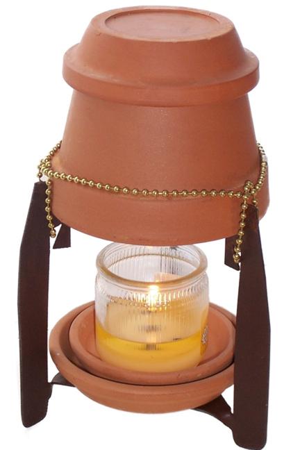

I found this really interesting candle or lightbulb heater that might be really fun to make and use camping. If I could just figure out how to make the lightbulb version 12volt ...
To see more, go to the website that sells it and also shows exactly how to make it at home:
http://heatstick.com/_KanHeet01.htm

An old fondue pot stand will get you started ...

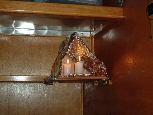

I've found candle heat quite effective in my 4x8. Pot would undoubtedly work better for heat dissipation than foil. I don't recommend this if you're the type who easily falls asleep while watching a movie in bed and stuff:

I was in Wally world last fall and they had the 2" 3" an 4" clay pots in the clearance section for 50 cents each I bought 1 of each with a drain hole and one 4" with a solid bottom. When I got home i rooted thru the junk hardward bucket and came up with a monster bolt and a collection of nuts and washers and bolted them in thru the drain hole dropped a candle in the 4" solid bottom and clamped on 3 bulldog clips like you use as a monster paperclip. This spaced the upper heat chamber up enough for the camdle to breath and while it took about an hour to heat the mass it did put off a surprising amount of heat.
P.S. dont touch the exposed bolt on top to see if it is warm just take my word for it it will be :shock:

So...thinking about this for a couple of days (no, I have nothing better to do ;)), I wonder if this is really an optimum design for a teardrop.
Obviously the heater doesn't increase the heat output of the candle or light bulb. Its primary intent would be to keep that heat from escaping the way it normally does (straight up, with a fairly small radius). The thermal mass of the bolt concentrates the heat in one place, and the pots diffuse the heat it so you don't burn yourself by touching the hot bolt. So it's probably better than a bare candle in the teardrop.
In the case of the electric version, the pots probably absorb a certain amount of light energy and convert it to heat energy. The thermal mass of the bolt is probably less important here, since the bulb's energy is less concentrated than the energy of a small candle flame. But it's probably better than a bare bulb in the teardrop.
If we decide we want a "flameless" system inside the confines of a teardrop, we'd then want to optimize the bulb system.
A bare bulb, fully (or mostly) enclosed in a single terra cotta pot painted flat black on the inside to convert the maximum amount of light energy to heat energy seems to me to be a more effective heating system.
Does that make sense, or am I breathing too much candle exhaust?
