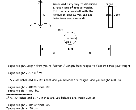

Postby deceiver » Sat May 08, 2010 10:08 pm
I measure my tongue weight by the quick and dirty method. I use my own body weight to balance the tongue then take some measurements and do a little calculation. I think it gives me a pretty good idea without having to devise a way to squash the bathroom scale. It also helps if you have a stick to hold your balance with and a friend to mark the points and/or measure for you

Postby starleen2 » Sat May 08, 2010 10:15 pm
The link seems to be broken.
I still use the old bathroom scales - but they lie to you anyways, right?

Postby regis101 » Sat May 08, 2010 11:18 pm
As long as the tongue is level it should work. I do the same for weighing most items that way. Since the link is broke I assume that you weigh yourself and then weigh yourself holding the object and subtract.

Postby deceiver » Sun May 09, 2010 5:19 am
I fixed the link.. sorry about that.

Postby Dale M. » Sun May 09, 2010 9:39 am
Lot less brain work to just put bathroom scales under tongue....
But If you have a bit of mad scientist in you its ok to use all the formulas and such, but it makes my brain hurt....
The other clue is if you release hitch and trailer tongue comes up and smacks you in chin, trailer to to heavy in rear.....

Postby deceiver » Sun May 09, 2010 4:02 pm
It may be easier to use a bathroom scale but My tahoe allows 600 lbs on the tongue and this little guy sport has a big cargo area. Most bathroom scales don't do a lot of weight.
And as far as the brain pain... It's first number divided by second number times your weight. And a good calculator is like an aspirin for brain pain. :thinking:

Postby Dale M. » Sun May 09, 2010 8:19 pm
A simple board ... one end on a brick , other end on scales,... Put trailer tongue exactly at middle of board.... You now have divide by 2 device.... In other words a 300 lb bathroom scale now can handle 600 pounds.... Just multiply scales reading by 2.. It all goes way back to Newton and beams and levers....We do this all the time to set up the race cars with $17 bathroom scales....
