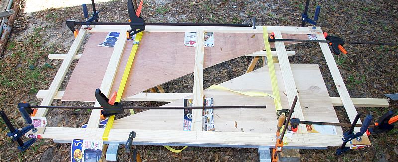

With nothing better to do right now (other than housework), I've constructed the framework for my wind wing. It may help and it may not, but I think it will look cool on top of the truck cap. Maybe some folks who see it may think I know what I'm doing.
:D
The photo is a shot of the base or wing (don't remember which), which are basically the same except that the two inside braces are offset an inch to mount the lift support. This piece is clamped to keep the parts flat and held tightly together while the glue in the biscuit slots dry.
Dale

Postby cracker39 » Sun Nov 28, 2010 1:21 pm
Kerry, building things is more fun than using them...to me anyway.
I’ve finished the assembly for some photos, but the wing is still far from ready. I have to remove the hinges, prime and paint them, and finish painting the wing itself. That’s as far was I’ll go for now. I need to build the trailer and hook it up to the truck to see how high the wing should be raised, then make the lift supports and attach the hold-down straps and the fasteners that will keep the wing either bouncing up or being lifted by a vacuum over the cap. I don’t want it flopping up and down while driving without the trailer attached.
The overall dimensions are 3’ x 5’. The support bar and the padded “feetâ€
Dale
